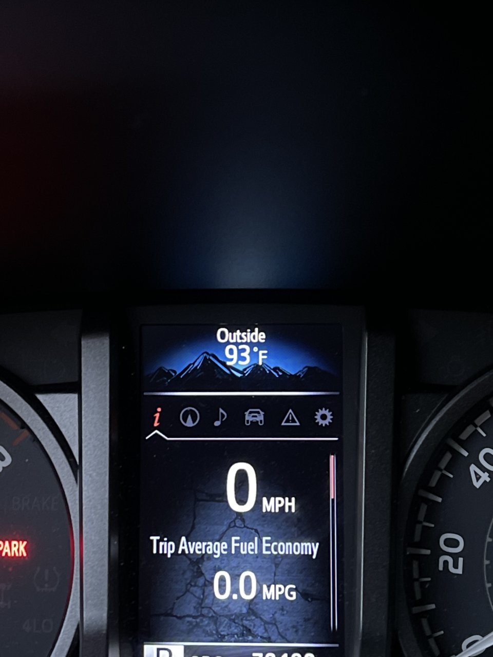

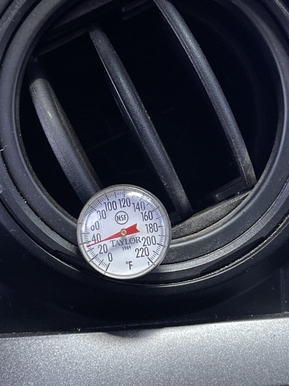

    Anyone using a thermometer - what kind of vent temps are you seeing? When the trucks hot inside I will start off doing 50, then 45, then once the truck is cooled down inside it will get right at 40 degrees. If my fan speed is too high it will then cycle on and off going from 40 up to 46 then back down to 40.

    Highway driving, my vents will tickle 32*. But just at idle, I’d say 45 is pretty fair depending on ambient.

    After idling 15mins or so. AC on full beans

    mine is cold enough to make my ears hurt, even in 100* temps .... yours should be too.
