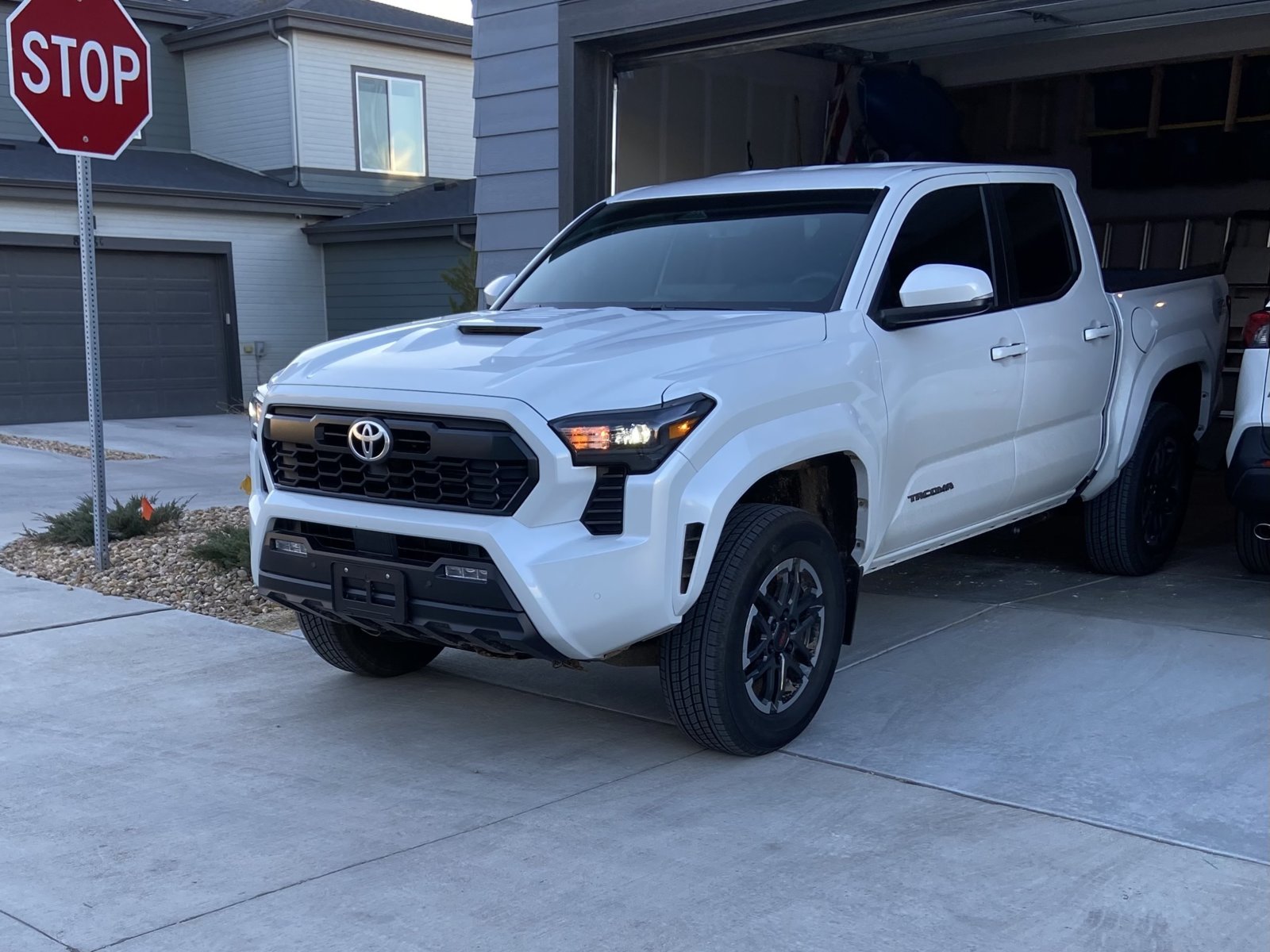

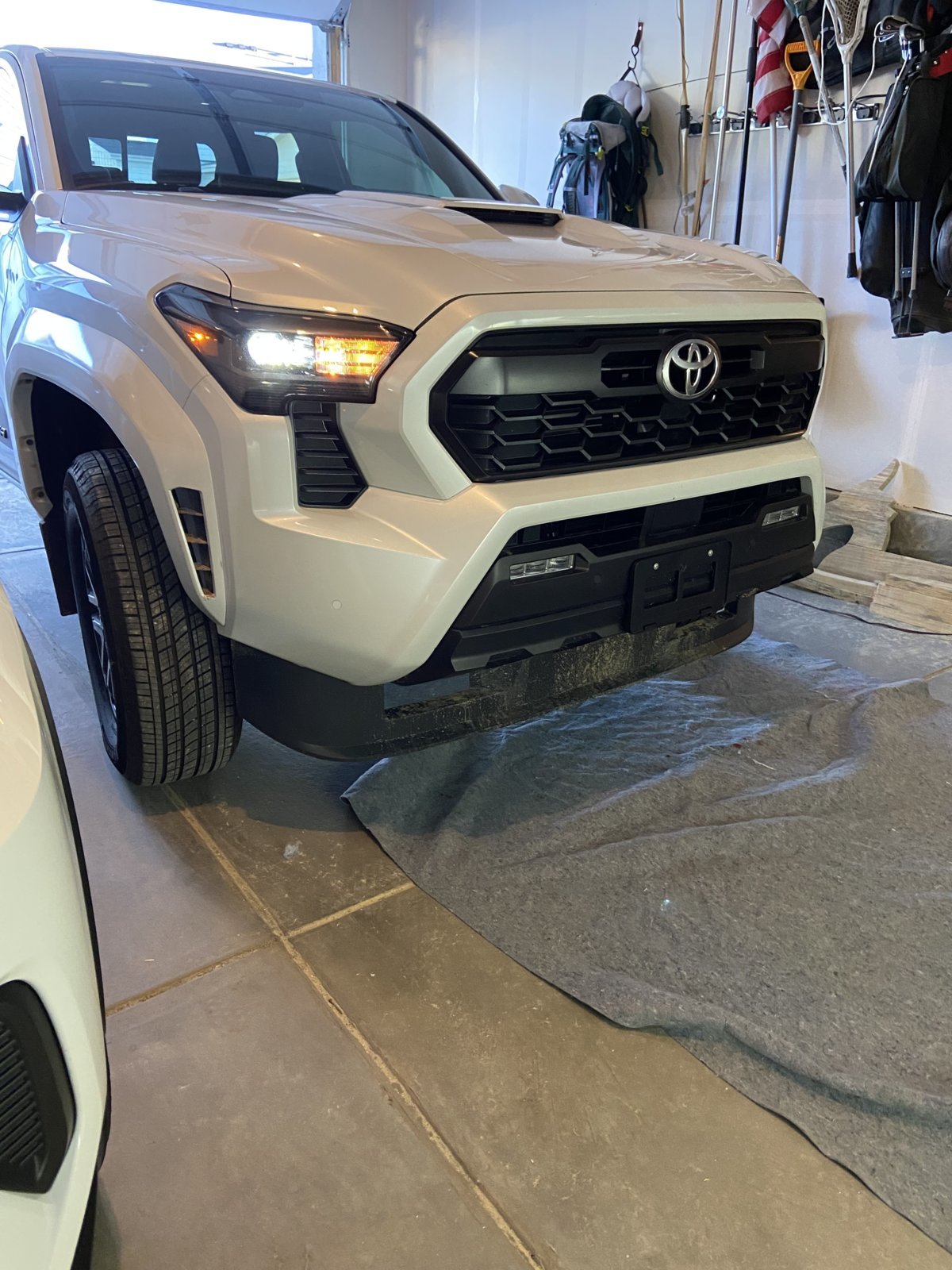

    2024 Blizzard Perl Tacoma TRD Sport
    Didn't notice the Air Dam (black plastic hanging below front bumper) when I first bought, but once I noticed it, it was all I saw when looking at the truck. Apparently, lots of other 4th gen owners felt the same, and Toyota attributes its inclusion in the build to MPG. They must have known we'd want to remove it since it's secured by only nine easily accessible 10mm bolts.
    ~700mi w/ Air Dam: 22.2 MPG
    ~600mi w/o Air Dam: 22.5 MPG
    Caveats: Truck has just over 2000mi total, so MPG might be skewed from "steady state". I drive exclusively in ECO mode when in town. <100mi w/o the dam were in 4Hi. IMG_4611.jpg IMG_4612.jpg

    I am guessing in a laboratory settings the air dam provided a very modest bump in mpg (sub .5 mpg). Since the EPA is all about laboratory tests and not real world tests, that is what Toyota is probably justifying having it for. I agree it's silly, but Toyota knows people think that and made it easy to remove so no harm done.

    Looks so much better without it...

    It is easy enough to remove at home without a jack or a lift or is it tough to get the ones in the back?
  10. May 6, 2024 at 4:57 PM
    JB_TN
    JB_TN Well-Known Member
    May 22, 2023
    #425186
    2,085
    JB
    Tennessee
    2024 Bronze Oxide TRD OR
    No lift needed and 90 seconds with the right tools.

    How did you secure the felt underneath?
  14. May 6, 2024 at 5:54 PM
    JB_TN
    May 22, 2023
    #425186
    2,085
    JB
    Tennessee
    Reinstall the bolts.
  15. May 6, 2024 at 5:57 PM
    FlyFisher1
    FlyFisher1 Well-Known Member
    Sep 2, 2015
    #163264
    364
    NJ
    Ah ok..I saw a post where a guy cut off the bottom but left the part that screws in. Sounds easier to just re-install the bolts lol

    Apparently you can just use a phillips head screwdriver as well.
    The felt looks kind of weird sticking out like that (obviously still better than the chin plow). Wonder how well it holds up to snow/mud exposed like that.

    Yea I learned that lesson. Slightly ripped up that felt liner due to the air flapping it... :anonymous:
