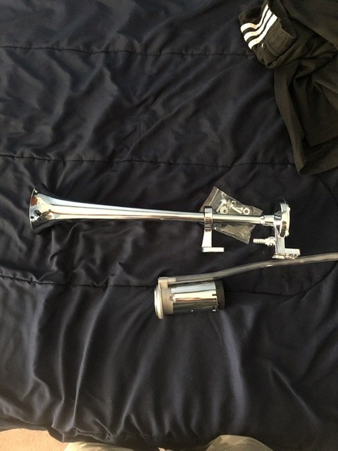

    So I’ve already got a Gampro airhorn wired up to my stock horn switch. I wanted to do something different this time, install another Gampro airhorn, but instead of tapping into my stock horn, I wanted to install a foot pedal switch, similar to the ones in fire trucks. My problem is the foot pedal switch has 3 wires: black, white and a green neutral. The 12v compressor has 2 hookups. I’ve tried it hooked up to a 4-pin relay, nothing. Hooked the + of the switch to the battery and tapped it to a + coming from the compressor and the switch did nothing, the horn was going off continuously. Quite a learning curve from the previous install I did. Any help is appreciated

  7. Jan 2, 2020 at 6:13 PM
    LeSueur1
    LeSueur1 [OP] Well-Known Member
    Oct 18, 2018
    #269864
    63
    Chandler
    James City Co VA
    2016 Silver Tacoma SR5
    Bilstein 2.5”, ToyTec 1” Taco lean spacers, 33” Gladiator X Comp MT’s, Method NV305 18x9 -12 offset
    Here’s the horn and the foot pedal switch

    Thank you, this damn switch has been irritating me all night, time to take a break for now. Does it make any difference that the switch is single postion, double throw and normally open?

    That is a SPDT (single pole double throw) switch. The 3 wires are NO (normally open), NC (normally closed), and COMMON. Figure out which are NO and COMMON. Those are the 2 wires you want to use. Make sure you insulate the NC wire.

    Gotcha, guessing NO is my positive and COMMON is my ground

    NO to the relay. COMMON to ground, IF you are using the diagram I referenced.
