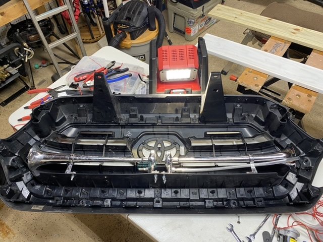

    Bilstein 2.5”, ToyTec 1” Taco lean spacers, 33” Gladiator X Comp MT’s, Method NV305 18x9 -12 offset
    This damn thing won’t let me upload the video, it works. And with both of these horns, it’s LOUD
