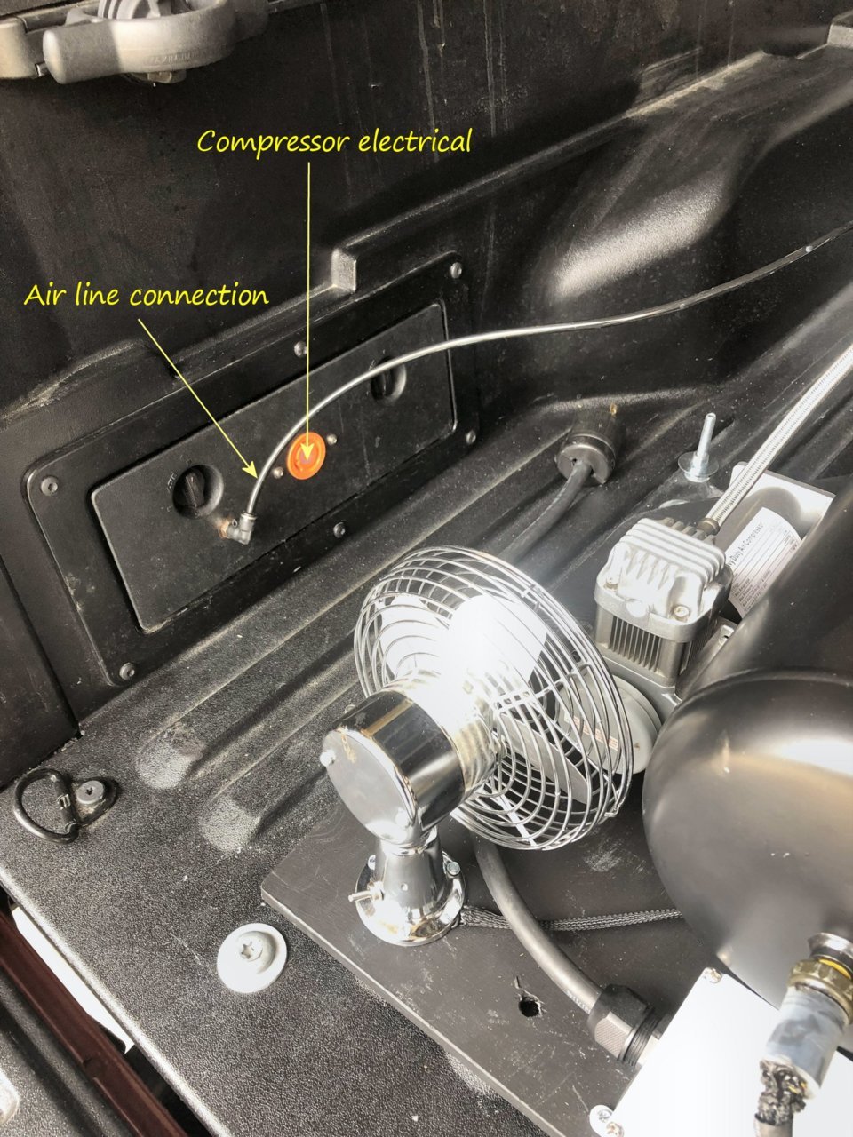

    Here's where our compressor and air line connects. I used a router and cutout for a electrical receptacle. 3-wire plug green=ground black=compressor white=horn button

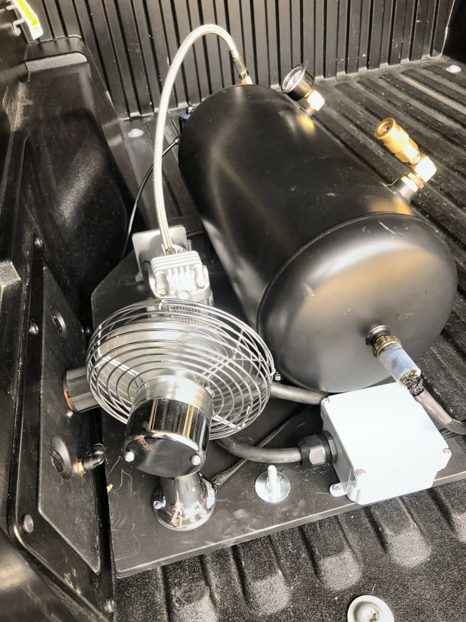

    Here's the compressor, tank, fan, and, electrical junction box connected. We have a bed cover so the fan runs whenever the compressor runs keeping it cool.compressor4.jpg

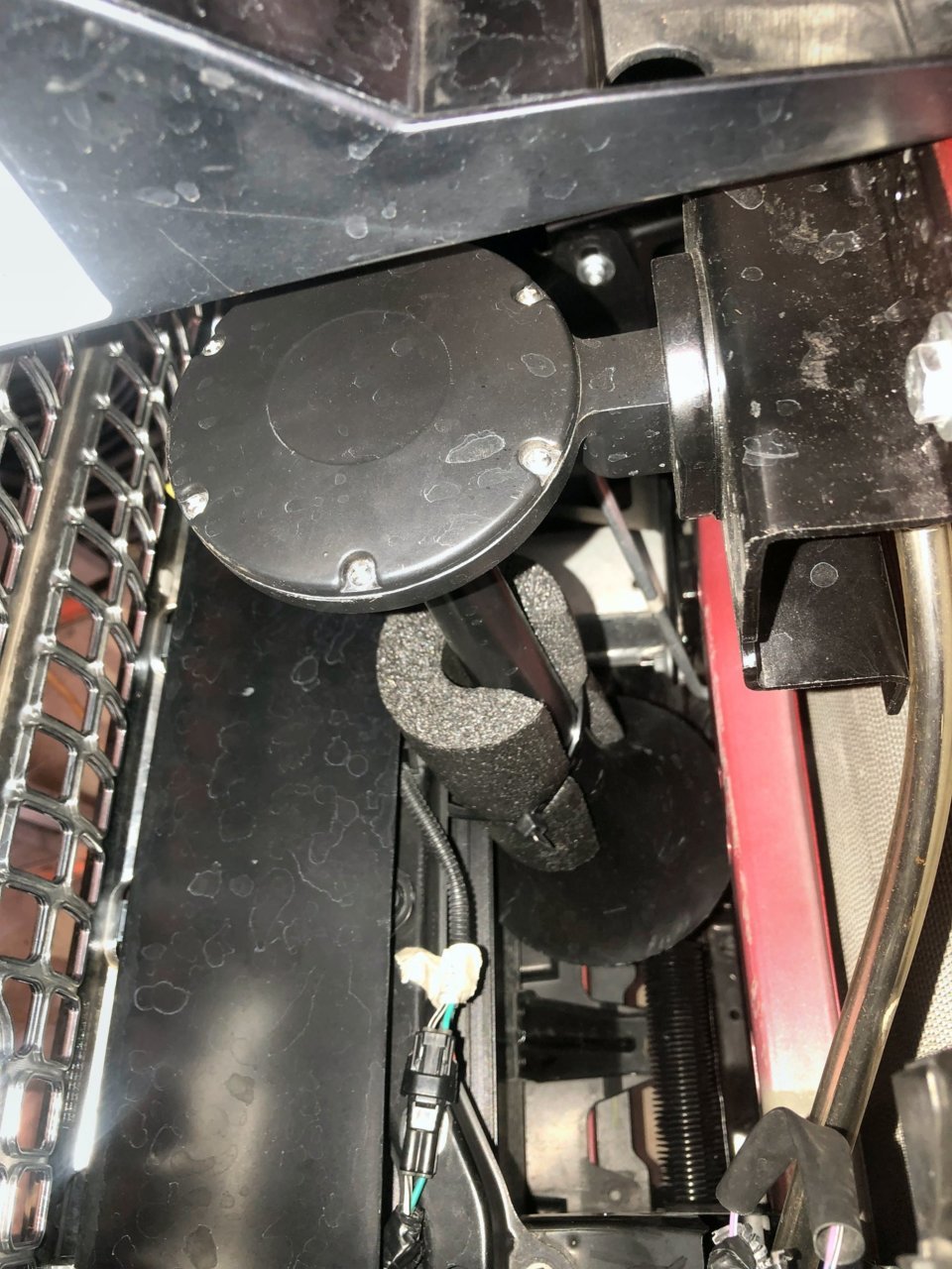

    We mounted a trumpet behind each of the headlights and the 3rd which is the longest just off center behind the grill. I used a short length of pipe insulation (pool noodle) and a cable tie to keep the trumpet stable.compressor2.jpg
