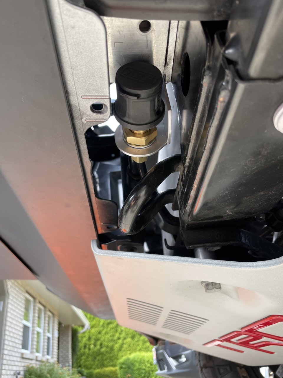

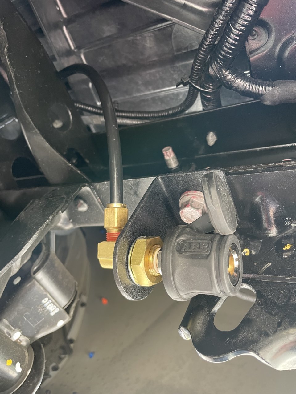

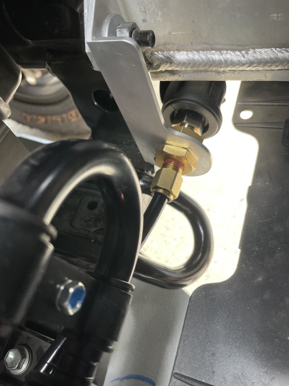

    I ran quick couplers from my ARB single mounted under the hood to the front and back of my truck. I considered putting the rear one in the passenger side cubbyhole but I decided against drilling into the plastic. Instead I made a couple brackets that would mount to existing hardware under the truck for a no-drill installation.
