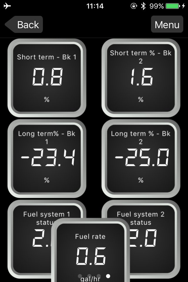

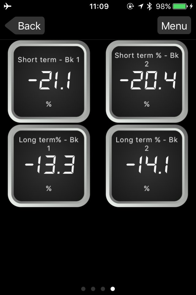

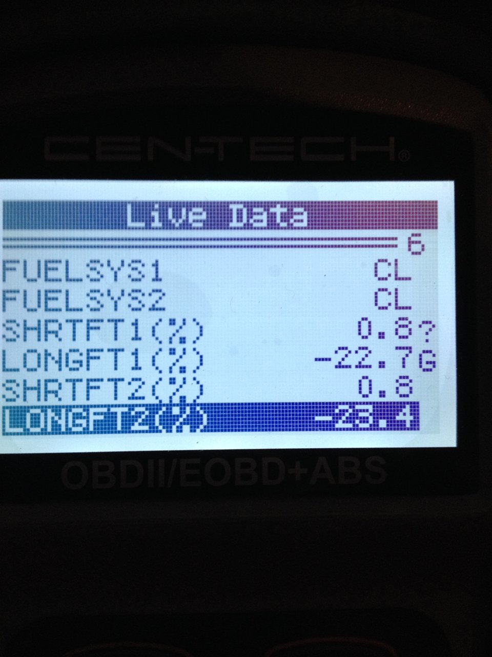

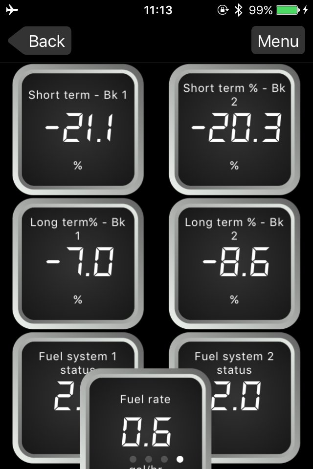

  18. Oct 14, 2020 at 11:56 AM
    #18
    dbbd1
    dbbd1 [OP] Well-Known Member
    Oct 16, 2007
    #3088
    403
    Here are some values. You thought that they should be positive? Oops.
    First pic is with the handheld scanner, other three are with OBD Fusion app.
    The first pic is after it gets into closed loop mode.
    The second pic is startup, third is idle, fourth is closed loop again.
    I check the fuel line again, no air this time. But, I have not driven it anywhere, these tests were just idling in the driveway.
    There was a noticeable stumble every time it went into closed loop.

  20. Oct 14, 2020 at 12:23 PM
    #20
    nd4spdbh
    nd4spdbh Well-Known Member
    Oct 7, 2013
    #114055
    14,601
    SoCal
    13 DCSB TRD OR v6 Auto
    holy jezus -20+% LT fuel trims.
    Bone stock i was seeing +-7% with things being normally around 2-4%+ With some maf tuning via hptuners im +- 1.5% now.
    Anyways, either injectors are sticking open / leaky, or O2 sensors are fucked. Im gonna probably say the latter, as you mentioned a stumble into closed loop (where fuel trims are utilized on a Realtime basis off of o2 sensor)
    TnShooter, b_r_o and Jimmyh like this.
