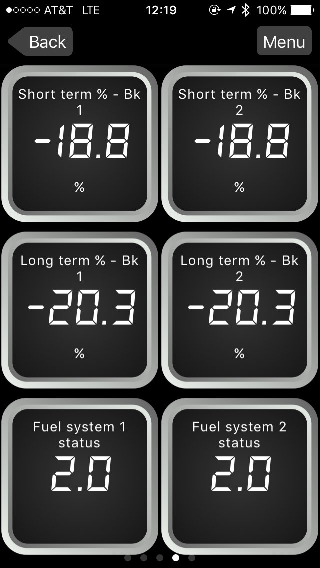

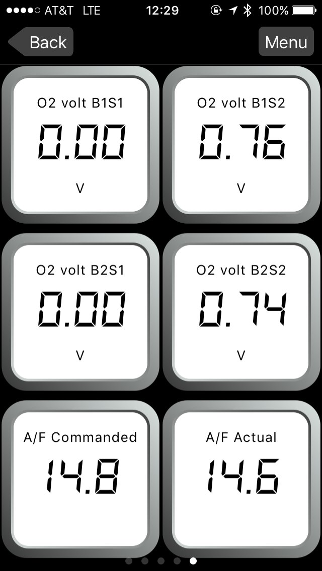

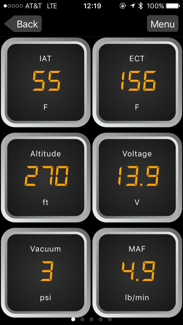

  16. Oct 15, 2020 at 7:17 AM
    #36
    dbbd1
    dbbd1 [OP] Well-Known Member
    Oct 16, 2007
    #3088
    403
    The saving grace, if there is one, is that this is becoming reproducible. I was afraid that every time I wanted to test things out, I was going to have to drive at least two hours, towing a trailer. Not where you want to be if it finally quits on you.
    Gas- Yes, usually among a few "regular" places. On the way home from camping most recently, no. I do get top tier or, at least, a branded gas station.
    I filled the tank approx 50 miles before the camping trip and again for the return trip home.
    In Oregon, it's not self-serve. I did not notice if there was or was not pressure.
    And it's a year-round blend of ethanol.
  17. Oct 15, 2020 at 7:51 AM
    #37
    JEEPNIK
    JEEPNIK Well-Known Member
    May 5, 2020
    #326895
    1,716
    2020 Voodoo Blue TRD Sport
    Check for over pressure in the afternoon and after driving. Is the blend different during winter and summer? Did they recently switch blends? Can you get straight gas?

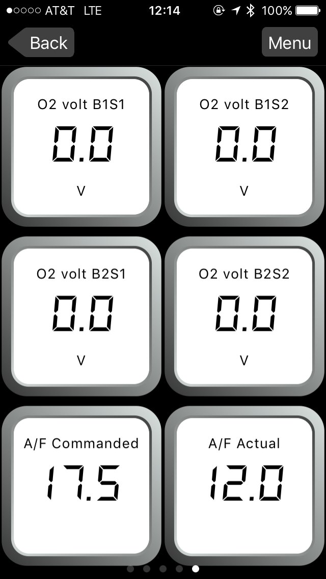

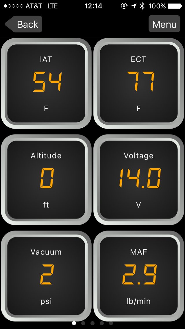

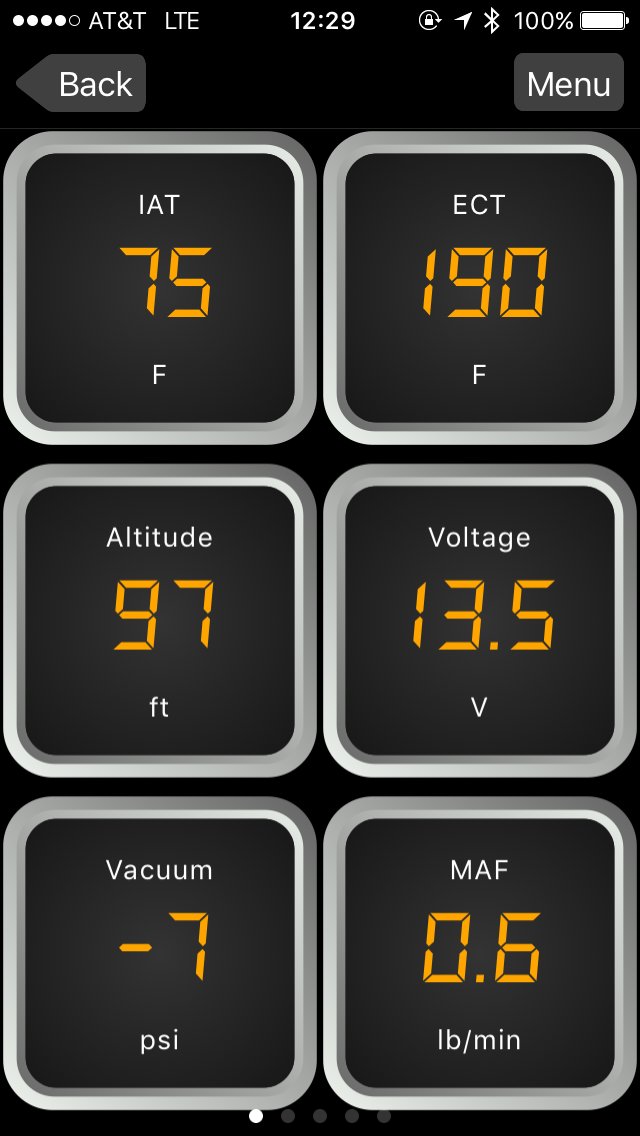

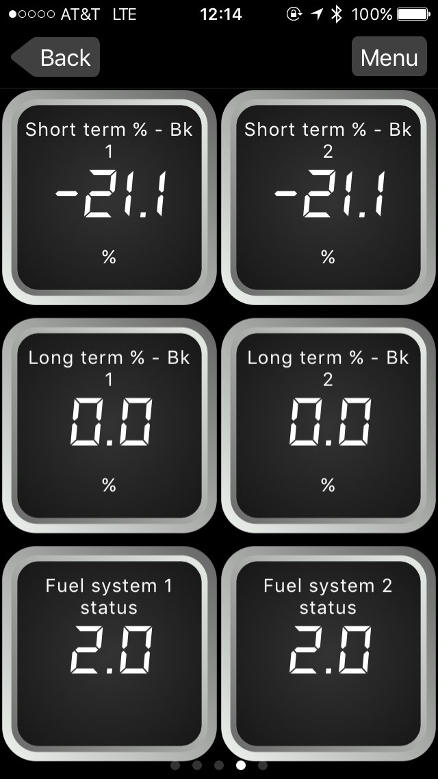

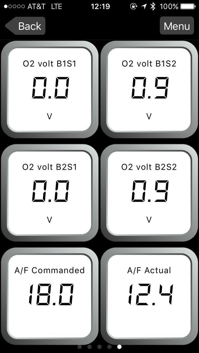

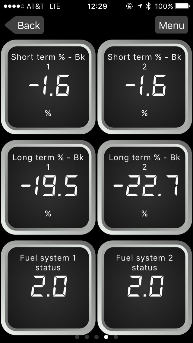

  18. Oct 15, 2020 at 1:17 PM
    #38
    dbbd1
    Oct 16, 2007
    #3088
    403
    Just took it for a quick 10 mile jaunt.
    I did a battery disconnect/reset too.
    Ambient was 56 when I started.
    Here are my readings...
    At startup
    About 5 minutes of idling.
    After its warmed up.
    I guess that I need to start looking at my O2 sensors? Why are both number one sensors reading zippo.
    Thanks again!
  19. Oct 15, 2020 at 7:12 PM
    #39
    Torspd
    Torspd Tor-nication
    Sep 18, 2009
    #22958
    26,453
    Tor
    The Great America!
    MMVI 4.4L 4x4 Access Cab
    Torspd Custom Turbo kit [] Borg Warner 9180EFR Turbo [] Haltech Elite 2500 [] TiAL Q BOV [] TiAL V44 Wastegate @ 15psi [] CP Pistons [] CP Carrillo Rods [] ARP Head studs [] ARP Main Studs [] ARP Header - Head Studs [] Ported Heads w/ 1mm oversized valves intake/exhaust [] Brian Crower Forged Stroker Crank [] Darton M.I.D. Sleeved Block [] Kelford Camshafts [] Torspd 160* T-stat mod [] APR Large Fuel Rail [] Walbro 460 LPH E85 Fuel Pump [] FueLab FPR [] APR T56 Conversion Kit [] KP RACING Built T56 [] McLeod Racing Custom Twin Disk Clutch [] One Piece Aluminum Driveshaft [] MGW Shifter [] Custom lowering kit [] Ohlins Front Coilovers [] QA1rear shocks [] Custom Ron Davis Radiator [] Dual SPAL Electric Fans []
    B1S1 and B2S1 do not read O2 catalyzation. They read air/fuel mixtures.
