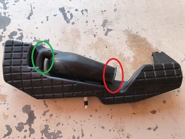

    DGXR
    DGXR Well-Known Member
    Sep 1, 2009
    #22094
    2,204
    Friend
    Sacramento, CA
    2006 2.7L SR5 2-wheel drive
    This is what the other side looks like. I don't think the tube (circled in green) is part of the engine intake airflow. I haven't messed with mine and don't plan to, got this image from the internet.
  11. Dec 28, 2021 at 3:19 PM
    Bizquick
    Bizquick Well-Known Member
    Jul 29, 2020
    #335977
    145
    Ethan
    Birmingham
    5 lug 2.7 AC 5spd
    As the air comes in the intake pass, some of the air is taken into that little pipe and into the large plastic bit
    DGXR[QUOTED] likes this.

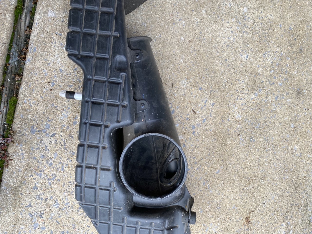

  12. Dec 29, 2021 at 10:37 AM
    Bizquick
    Jul 29, 2020
    #335977
    145
    Ethan
    Birmingham
    5 lug 2.7 AC 5spd
    There is the entry for the air diverter thing.
    You can see the small hole for the pipe mentioned by DGXR above that leads into the plastic “box”

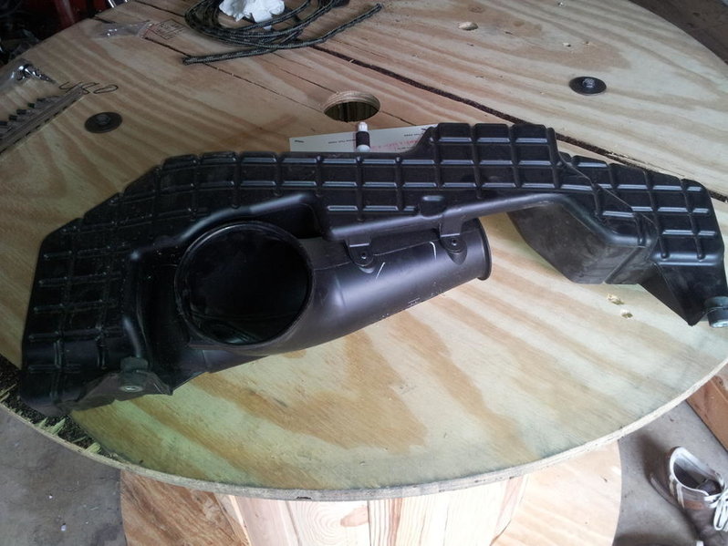

  17. Jan 2, 2022 at 4:19 PM
    #17
    Nyrob
    Nyrob [OP] Well-Known Member
    Mar 4, 2021
    #358202
    785
    Robert
    2021 SX 2.7 AT 4WD
    5100 1.1 Front, 5125 Icon Stage 2 Rear, 5.29's, LCE Header
    I pulled it out today just a fyi for anyone looking to do the same, just cut the head off the factory push pin style clips in the fender liner they are a pain to get out. I was able to cut the heads off toyota's stupid panel clips, unbolt the few screws on the front half and just bend the fender liner down to pull out the intake silencer. It pulls right out no hardware to fuss with, I then picked up a box of universal push pins from harbor freight to replace the ones i cut. I notice almost no increase in noise would recommend anyone with a 2.7 to just pull it out.
