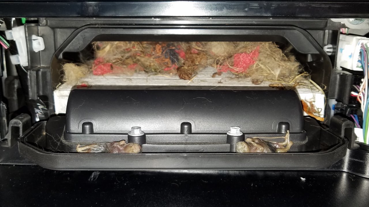

    Comb
    Comb Known Member
    Oct 27, 2016
    #200814
    1,834
    2017 TRD Sport 4x4 DCSB 6MT BBP ABCDEFG
    OVTune Verified Purchase

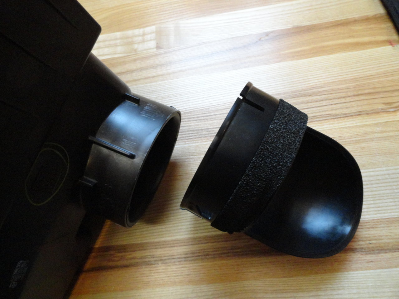

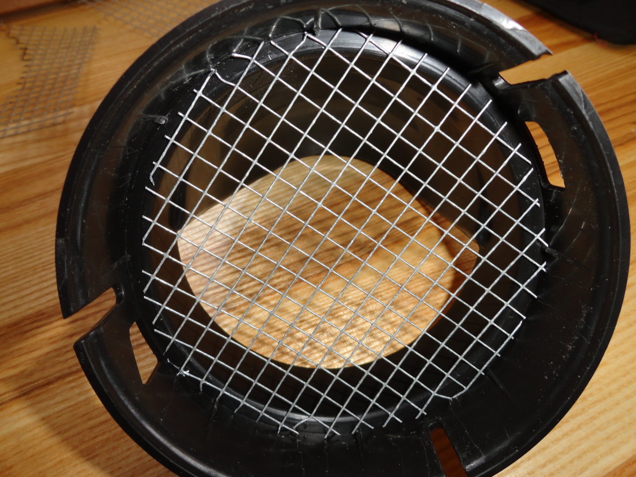

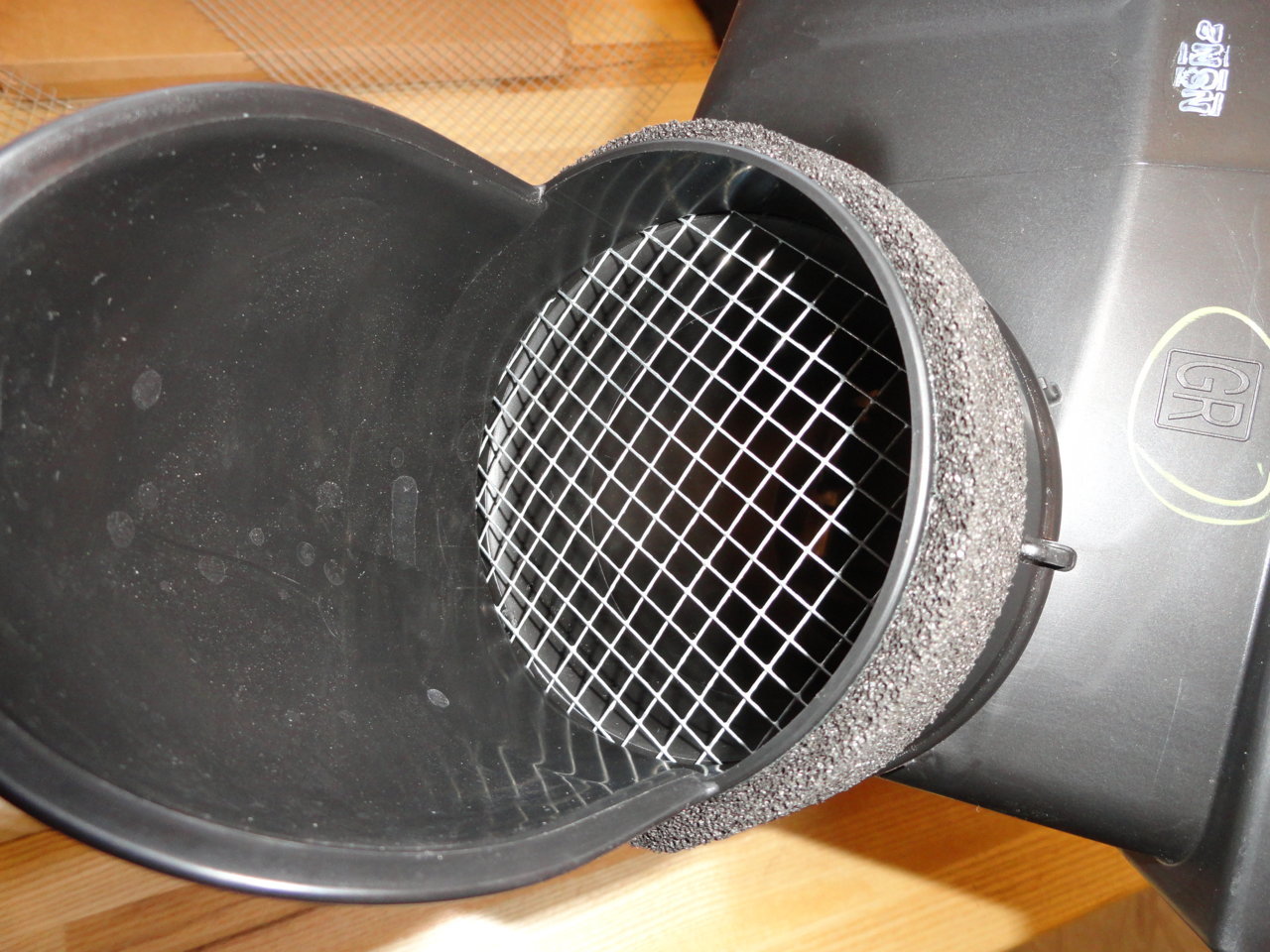

    Here are some pictures from when I screened the engine air intake.

    This is a cursed image.

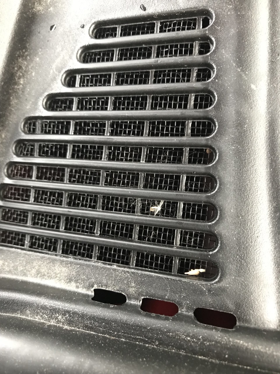

    WOW guys thnx so much for all the great info. I went out and looked at mine {pics} and it looks like Toyota read ClearwaterBills other post. But I am going to double check it tomorrow when its not raining. RichVt- great idea gonna do that one tomorrow. Comb- I had similar situation in my last Tacoma,,,stuck in the heater fan,,,ugh. Priceless information,,,thnx

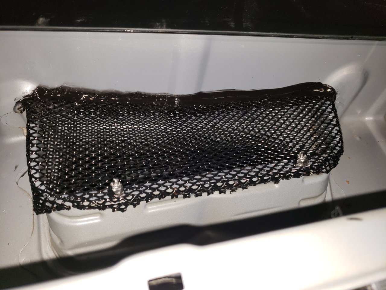

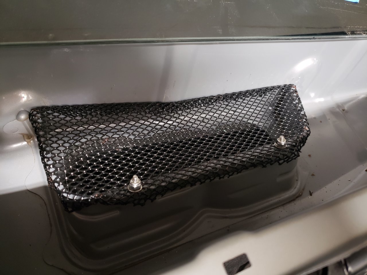

    I recently screened off the cabin intake in my 2019 using some metal mesh from Lowes. You have to remove the wipers and plastic cowl:
    Though it is secure I applied a bead of 100% GE silicone to keep pine needles and debris out of the rear part next to the firewall.
    I need to mesh off my engine air intake next. I highly doubt that mesh is going to affect mpg or hp unless it really gets plugged.
    F*$!! # mice!!

    It's going to affect it a lot less than a mouse nest in the air cleaner will.

    Thank you ALL for the great info. Today I got the same gutter screen as MtnFisher ( thank you for the idea ) and am going to do the same thing that RichVt ( thank you for the idea ) did to his engine intake .
