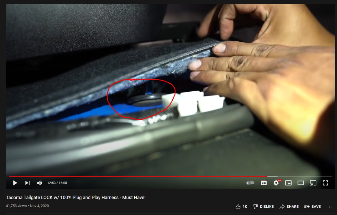

    There is a plug under the passenger floor that covers a small hole. I doubt that hole is the issue though
    Here is a picture of what I'm talking about

    The drain is in place, but good thinking. I don't see anything missing or loose around the blower motor.
