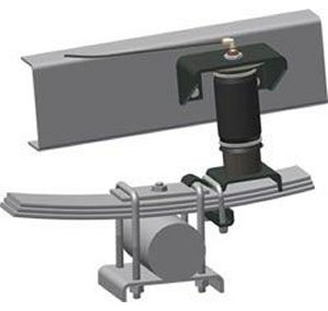

    I am totally stock. Other than the bags. I have to believe that because these bags ride forward of the axle on the spring and not center of the spring on the axle that must have changed the geometry in some way or that is at least my thoughts!

    That is interesting for sure.. where do they bolt up on the frame? Mine go right where the old bumpstop was and use that reinforcing plate for the bumps for extra strength..

    They bolt to the frame on the bottom side of the frame just forward of the axle.
  10. Apr 17, 2018 at 1:00 PM
    Bleuboy
    Bleuboy [OP] Member
    Apr 8, 2018
    #249881
    15
    2010 tacoma 4x4
    This is how they attach!
