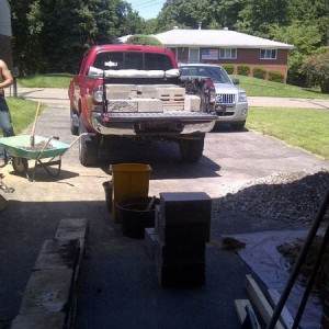

    I've never seen that with my truck. Just a couple weeks ago, I had 2,800 # of no. 3 crushed stone in it & the only problem I had was the bottoming of the suspension.
    I haven't received a response from Air Lift yet & I'm leaning very much toward the Firestones now.
