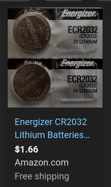

    Check the battery in the wireless remote, start with the easiest solution.
