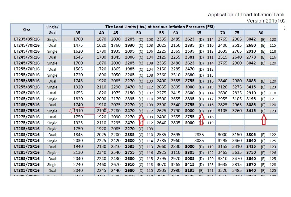

    C vs E has little to do with it.
    A C has a max psi of 50; E has a max of 80 psi.
    A C and E, of the same size and pressure, will have the same load capacity, up to 50 psi.
    What size?

    37, same as OP.
    1,954 lbs falls between 35(1,910) and 40(2,100) psi.
    5 psi=190 lbs
    1 psi=38 lbs
    35 psi(1,910 lbs) + 2 psi(76 lbs) = 37 psi(1,986 lbs)

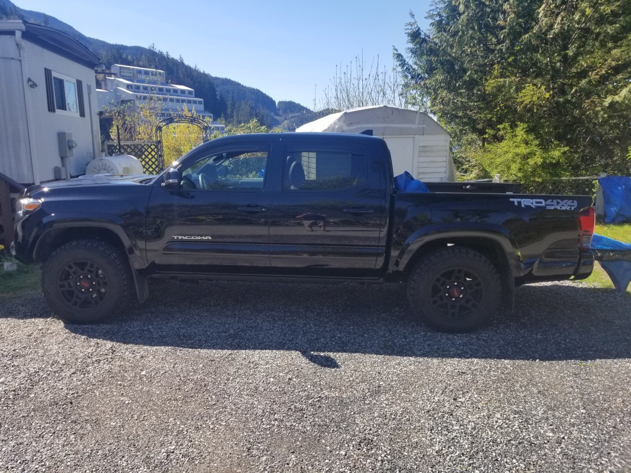

    Thats with a yard of gravel @30 psi. Tires look pretty good, so i never gave it a second thought. Will look into this chart later on tonight.
