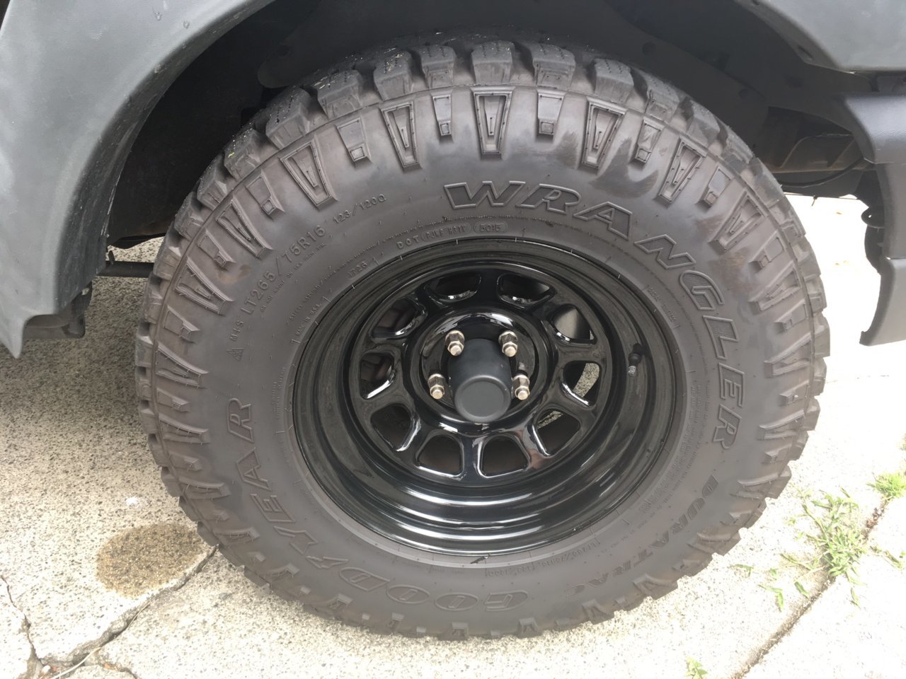

    I have 265/70/16 Duratrac 112S on a ‘17 dcsb 4x4 OR. What tire pressure is recommended? Driver door jam says 30 psi. Thoughts, feelings?
    Took em for a cruise at 60mph on highway, and neighborhood 25mph. No vibration in truck. Next day on an different relatively smooth highway there was a bit of wobble/shake. Very minor but noticeable. Noticed I was going 50-55 mph when it occurred. Re torqued, all still at 83 ft/ lbs.

    Are these brand new tires for u? You could've thrown some wheel weights...

    Those are E loads? I would run at least 35 psi.

    Your new tire is the same load rating as the stock tire(euro metric 112SL).
    30 psi

    Brand new, yes. Good point. Might have to get em checked.
