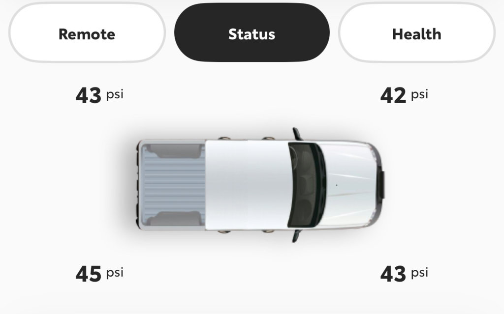

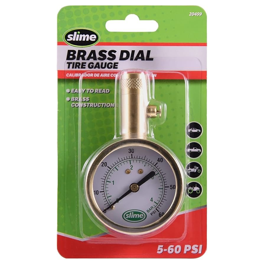

    Just curious if anyone has compared the tire air pressure from the Toyota app vs say an old fashion mechanical one similar to this one?
    Were the tire pressures the same?
    I’m going to have to break mine out and test it
    just curious

    The app is just showing what the TPMS sensors last reported. You will be testing against it. Mine tested just like the industry; within one or two psi.

    Personally I’d put more faith in digital TPMS sensors than an inexpensive wide range mechanical gauge.
    Though the TPMS on my 3rd gen is always within 1 psi of the digital gauge on my ryobi inflator, so it’s all good.

    Why are your tires at 42+psi?

    As the vehicle cools off, the manually measured tire pressures will begin to lower, but the app is displaying last known pressure, as the tpms only transmits pressures when vehicle is in motion, and after several minutes of inactivity the tpms will "go to sleep"
    So, don't misconstrue cooling wheels with erroneous tpms readings.
    BTW, the tpms in our Toyota and Nissan seem to be dead on to a quality gauge
