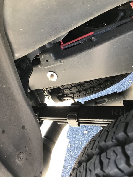

    Silly question(s). Can these be inflated with a regular bike pump? And where do you normally route the valves...a place I am looking at for the install does it through the rear license bolts :)
  4. Mar 14, 2017 at 11:33 AM
    #24
    perkj
    perkj Well-Known Member
    Aug 31, 2016
    #196051
    976
    yes they can be installed with a regular bike pump. I have my valve mounted in one of the frame holes that sits behind the rear tire on each side. I'll take a picture later today to show you what I mean.
    TacomaGinger likes this.

    976
    As promised:
    eurowner likes this.

    Thank You Sir. Looks clean. Have you had any issues with dirt getting in there or can they be capped off like a bike/car tire valve?

    No issues and they are capped in the photo....they come with "clearish" caps. BTW - you'll just want to pick up a 4 large fender washers to mount them like I have (2 per side of the truck and a washer on each side of the frame.
