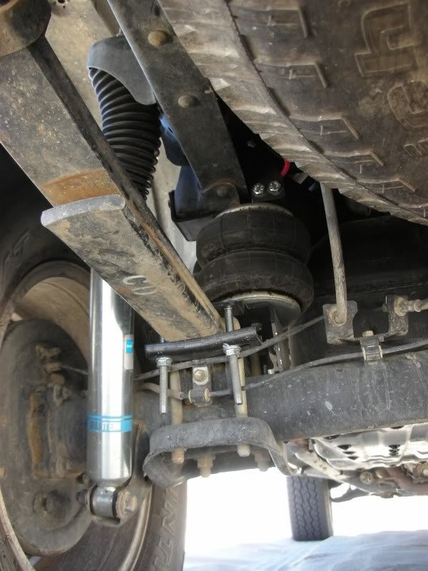

    Firestone Airbags ARE Camper Shell
    New member here and first post (go easy on me) at least once !
    I haul about 500#plus every day on my 2005 taco plus a steel cab high commercial shell and I have a set of Firestones ( #2407 ) Airbags and they are great for me.Bear in mind that 99 % is on Rd driving. I also will haul a 2000 # pop up camper flipped axle and 4 inch sub frame lift.It is very usefull that I can maintain proper level with the airbags. BUT I dont wheel like most off roaders here.I handle forest roads with no problem and light trails.
    My last truck was 1997 4X4 Taco with airbags and I had that setup for 175,000 miles with no problems.Hope this helps.......

    Ride Rites worked awesome on my 2005 DC with the bottoming out rear end (didn't know about TSB and dealer said that was normal, so I fixed it myself)... by going to Off Road Warehouse for the install.
    Ran mine at 15 psi for normal loads and up to 30 psi with heavy camping load, ice chests, etc. Totally solved the problem and I kept them when I traded the '05 for the '10 (in case the '10 was too soft)... The 2010 has better springs, so I don't need the air bags on it.
    You don't need a compressor onboard... you can add air from any tire air source or an electric tire pump, like we all have for off roading!
    I also changed the back shocks for 5100's and they were great!

    I use the Air-Lift ride control springs on my 96, and like them quite a bit. While having good springs is important, even brand new springs can't offer any adjustability. They are either too low while loaded, or too high while unloaded. I think for people doing real hauling or towing, the air springs are a great way to keep things balanced.
    I have the basic bags, no onboard air (though I do have a MV50 in the cab, mostly for tires). Typically I'm loading up at my workshop, and set the pressure there, or I'm pulling a trailer a long distance and adjust at the first gas station. Because the bags hold so little air, they can be tricky to set at the right pressure. I'd recommend getting a good dial gauge with a push-button bleeder valve. I find it easier to slightly overfill the bags, then use the bleeder to slowly drop down to the right height. I find myself running between 10psi unloaded (I have a shell) to 50psi fully loaded.
    I have both bags setup with separate schraeder valves so they can be different pressures - which comes in handy if you have offset loads.
    I've had mine over a year now, and had no problems at all - they look good as new. I don't do a lot of hardcore wheeling, but I do go up old jeep and fire roads, and have drooped the rear springs pretty darn far without damaging the bags.
    And having been able to experiment with the leveling of the bed while heavily loaded, I can say that it really changes the handling (for the better). You don't notice how bad the handling is with your nose in the air until you correct the problem and realize how out of control you were. Same with a heavy trailer. I used to tow regularly with my old Mercedes that had self-leveling hydraulic suspension which taught me how important a level ride is when loaded.
    Don't use the springs to "lift" your truck, they aren't designed for it. While it can push you above stock height, you should really just use them to return the truck to it's normal unloaded height. I'll probably be upgrading to OME dakar springs sometime soon, but I expect to keep the air bags as well.
