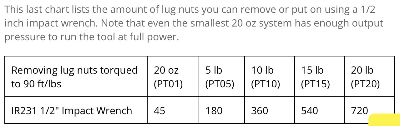

    For tires, a 5lb co2 tank will take a 32” tire from 15psi to 35psi about 10 times. So that means your 20 tank should do the same psi increase just over 2 times.
    For tools I think it really depends on what you want to do. Here is a chart from the power tank web site.
