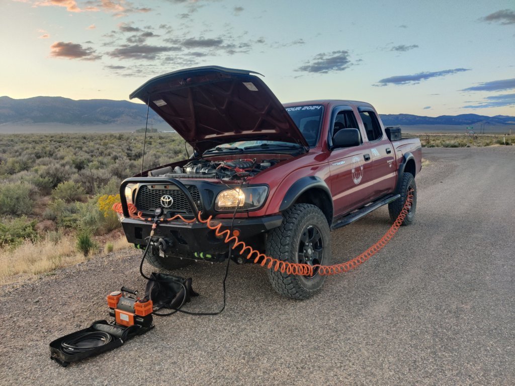

    IMG_20240918_193235.jpgill second the 12v compressors. There are definitely cheaper options like the Napa one above. I picked up this EZ Flate M.O.A.B Compressor and Recoil Hose System second hand on a recent trip and have been very happy with it. The compressor looks almost identical the the Napa unit listed above but it's a solid $100 less. More flate also sells similar compressor and hose systems. These pumps are quick and since it's not mounted they can be moved between vehicles

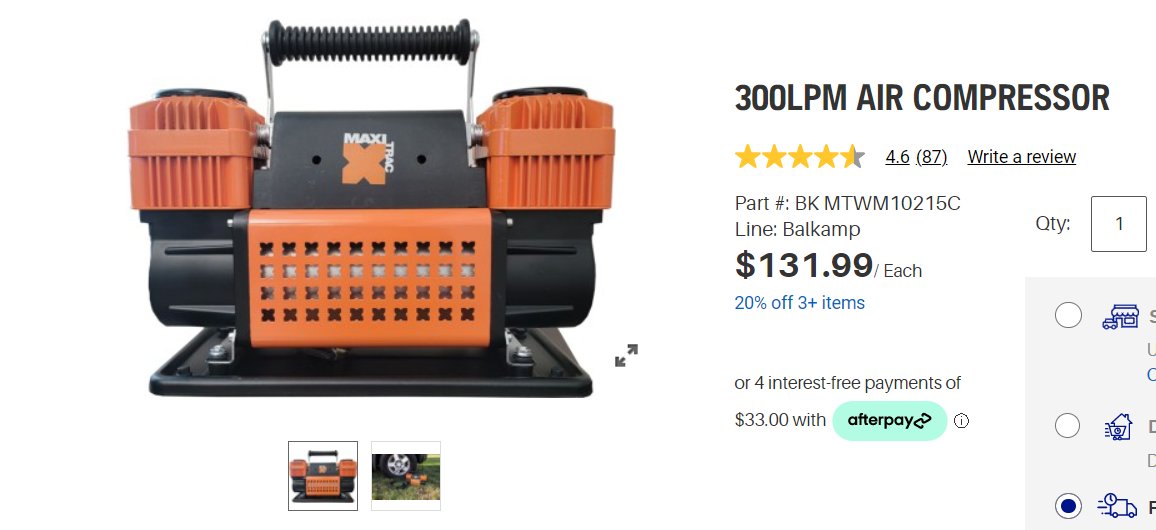

    Not sure if there's any meaningful difference between any of these compressors. They have the same output, the same form and function, same CFM. The Napa one is now listed as a "300 liters per minute" because that sounds so much better than 10.5944 cubic feet a minute. The only thing that seems to differ between brands is the paint they add to them and the warranty. Napa's is $122.50 shipped, less tax with the myriad of 20% off coupons they always have.
    Edit: Someone on reddit makes the case that the Moreflate is in fact upgraded from the basic chicom 10.6 cfm, and that for single tire filling the 10.6 cfm might be excessive.
    Good thread overall:
    Those of you with onboard 12v air compressors, which did you buy and are you happy with it? It's time to add one to my trail beater. : r/4x4 (reddit.com)

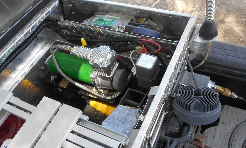

    My truck has a Viair 450 series hard mounted in the crossbed tool box - the box has a heavy cable wired directly to the battery for high amp power. I wired the compressor to be regulated with a pressure switch that keeps it at or below the 100% duty cycle. There is a small receiver to allow a bit of surge capacity - keeps the compressor running as I switch between tires.
    These 12v compressors are a pretty heavy electrical load - so I always run the engine while its in operation.
