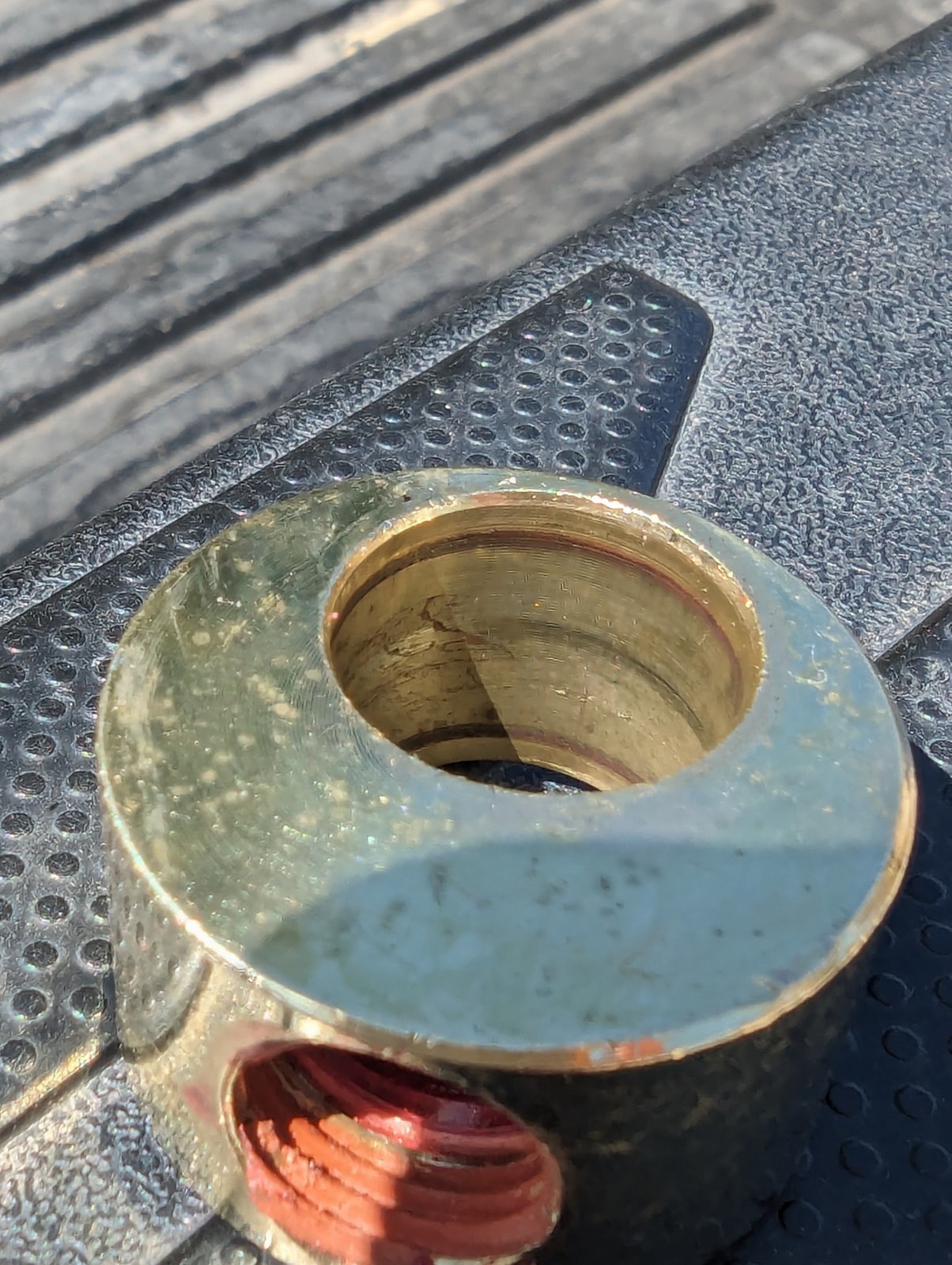

    I bought a 50' retractable air hose from harbor freight. I love the thing but from the day I bought it, it leaked. After opening it up, it looks like a poorly designed part. Looking at picture 3, it's not exactly a precision part. I'm guessing some thick grease could help a little but I don't think it's going to fix my problem.
    The in and out are just regular old 3/8 NPT. The only one I found so far is $85. It looks like it's a bit overkill for what I need. Is there something else I can use that is a little cheaper but better than the garbage that I have?

    I polished the inside with a Dremel and rouge. Added grease and now it's fine.

    It's a central machinery. After polishing and greasing it, soapy water shows no leaks. I don't know if the polishing did anything. At the very least, you should try grease.
