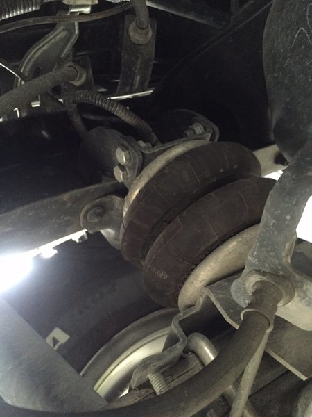

  7. Jul 12, 2015 at 8:15 PM

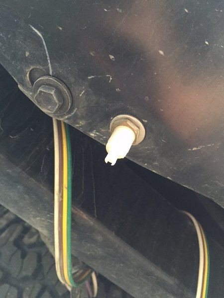

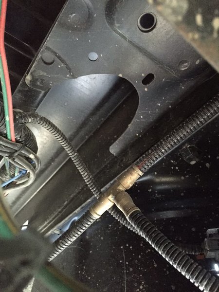

    okay so check these couple more pics what is this? lol kinda a truck noob thanks for the help

  10. Jul 12, 2015 at 8:29 PM

    Access cab with child seat in the back, yellow wire mod, diff breather relocated to tail light, engine block heater, Leer topper with Yakima tracks and rack, Yakima rack on cab, Ride Rite air bags with Daystar cradles, CBI hidden front hitch, wired for winch front and rear Warn quick connect, Warn x8000i on external carrier, sway bar delete, trailer plug relocated to under bumper, Pelfreybilt IFS and Mid skids, BAMF Tcase skid, ECGS front diff bushing, ARB CKMA12 compressor, 255/85/16 Backcountry MT 3 load E tires on stock steel rims, Toyo M55 tires (same size) on another set of stock steelies, Up2NoGood heated mirror kit, Husky X-act Contour front floor liners, Northstar AGM 24F battery under the hood, Northstar 27F in the cab, Redarc 25 amp DC to DC charger, Pelfreybilt bolt on sliders with kickout and top plates, TRD Pro headlights, Depo smoked tail lights, Energy suspension body mount bushing kit, OME Dakar leaf packs with AAL, OME rear shocks, OME 90021 front shocks with 885 coils, SPC LR UCAs, Up2NoGood 2wd low range mod, 4 Wheel Campers Grandby slide in camper, 4xinnovations high clearance rear bumper, Uniclutch 800 lb/ft clutch
    Firestone RideRite air bags

    What this guy said ^^^
    If you're gonna haul heavy loads add some air to the bags and your truck won't sag as much and it'll ride a little better.
    I'm not sure what the max PSI is on them (IIRC most people run 5 PSI in each bag).

    so thats after market? whats the purpose of them?

    Huzzah, simple troubleshooting techniques FTW.
    To stabilize a load and lift the rear end.

    so its for heavy loads? awesome!

    Supposed to run 5psi minimum at all times for the sake of the bags being happy. Load capacity is roughly 50# per psi (both bags) so 5psi would be roughly 250# added capacity....great for towing and loads, they do not up the capacity of your vehicle, they simply help cut sag and such when loaded. Lots of threads on the subject on this forum "Firestone Ride Rite Airbags".

    In general, 10psi for an empty truck, 15 - 20 loaded. 35 for "shit, that's heavy!"
    They can be safely filled to 100, but you would only need that if there was a Ram 3500 in the bed of your Taco - there's no reason to fill over 50, our trucks can't take that kind of weight anyway.

    Yep, freebie upgrade. Unlike stiffer springs, these don't hurt the ride when unloaded.
