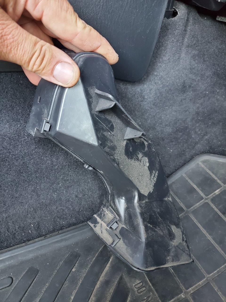

    That floor vent is just clipped on, it takes a little finigling to get it off but it comes off pretty easy.

    Is this on the drivers side?

    Passenger side
