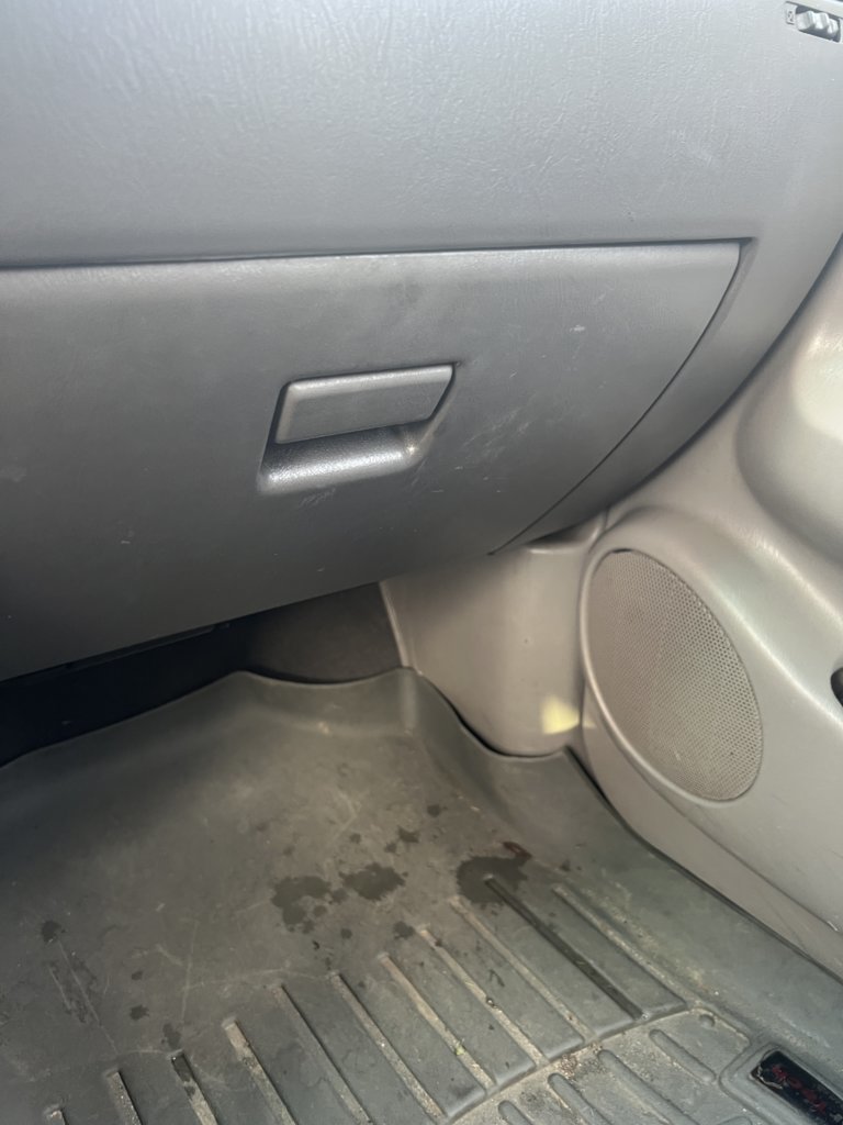

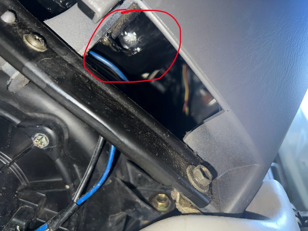

    I’m on a long haul and noticed something leaking by the glove box, has anyone had this happen before? AC is blowing ice cold, I’m assuming it’s something to do with a condenser

    There was a bunch of totalled 4G tacoma on Copart with the tiniest amount of water damage. Some where the water line was just barely higher than the bottom of the doors.
    For mold, I've had good luck with a peroxide-based cleaner like this for removal of visible mold and mildew:
    Alpha-HP® Multi-Surface Disinfectant Cleaner | Diversey Global
    A quat-based cleaner also works. Odoban from Sam's Club (or really anywhere but they have it cheapest) works too. Longer dwell time for molds.
    This company sells chlorine dioxide tablets:
    ODOR-CLO2 Chlorine Dioxide Tablets (1 x 500 grams / 1.1 Pound) - Safrax Chlorine Dioxide
    There's an entire barge of shit with this company and its quackery, so stick to the facts on what these are for. These things are brilliant at fumigating your car to get into crevices, gaps, behind the dash, into vents etc. It is seriously creepy, like a WWI toxic battlefield. I've done it on a car before that had the sunroof left open in a downpour and the car smelled like a pus-filled locker room before treatment and stink free but slightly hospital for a few weeks after. The lingering hospital smell fades.
    Seal the car up and leave it overnight, ideally in a garage or at least out of the sun. The tablets will begin emitting a very deep yellow toxic gas that oozes through the car killing literally everything. You can see it happening through the windows. Once you've let it sit for 12-24 hours, open all the windows and let it air out for a while. Don't breathe that shit. Strong oxidizer. Park it in the sun to neutralize the chlorine dioxide. UV inactivates it.
    A carpet extractor will also help. Some all purpose cleaner, whatever your fancy, diluted about 10:1.
