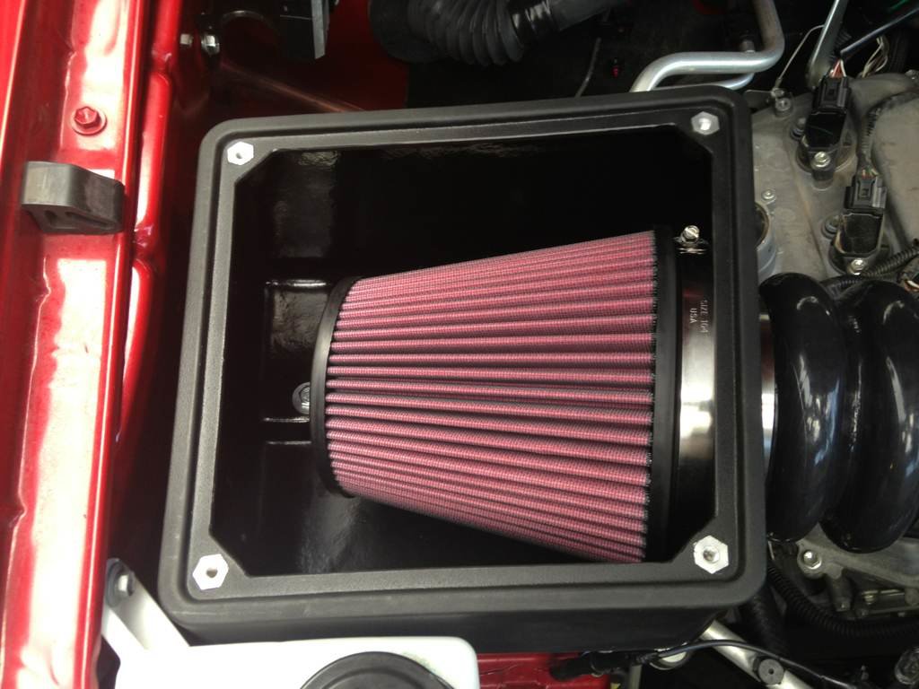

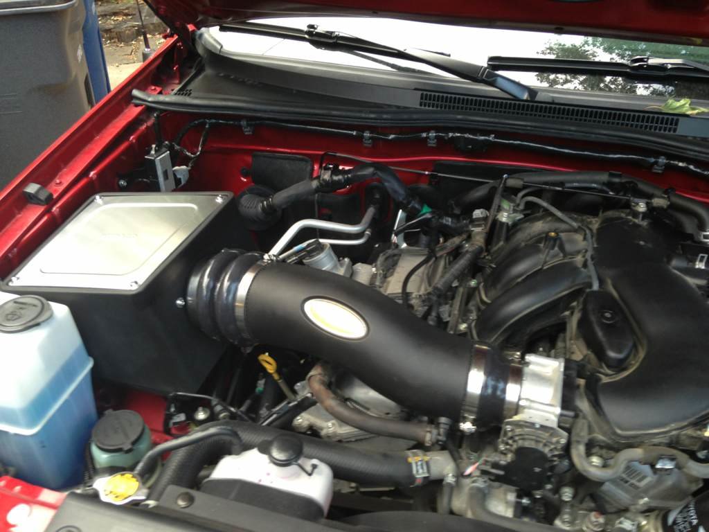

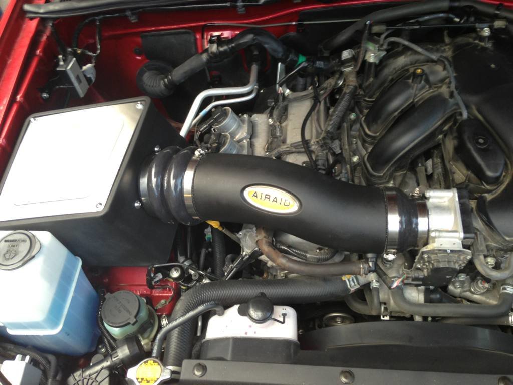

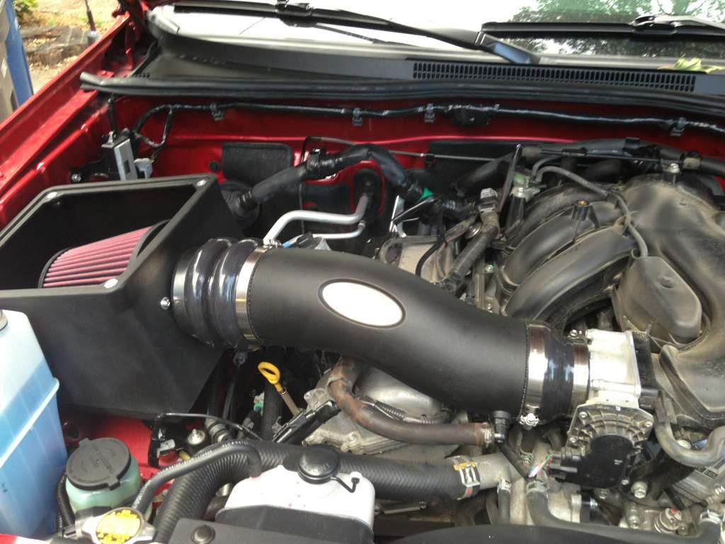

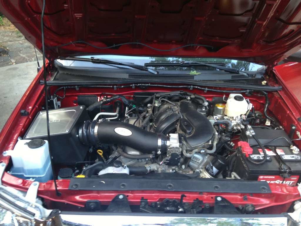

    I could find very little discussion on the Airaid CAI so I figured I would bite the bullet. By far the most intricate cold air intake install I have ever done. I had to relocate the AC line bracket, cut and splice in a wiring extension for the air pump per the instructions and a few other things. On a positive note fitment is perfect and no cel. Road review and possible vid tomorrow. This thing is huge and engine cover will not fit. But so far I like my little noise maker.

    The MAF sensor is on the bottom of the main tube, about halfway (basically underneath the Airaid logo).
    This is the only thing I wonder about with this kit... I think those of us that have it may be replacing the MAF prematurely because of this. Every auto maker hangs the MAF down so moisture can't gather on it when driving in inclement weather... but we'll just need to wait and see.
    Also, during installation I found it impossible to use the supplied wiring extensions for the air pump- the spades on their wires wouldn't fit in my connector properly, despite my modifying on the bench grinder for an hour. I ultimately cut the factory harness halfway and spliced homemade extensions in using wire the same color & gauge sealed with heat shrink solder style connectors. I wrapped everything, including the now rerouted ac lines, with plastic conduit to keep anything from chafing over the life of the vehicle
