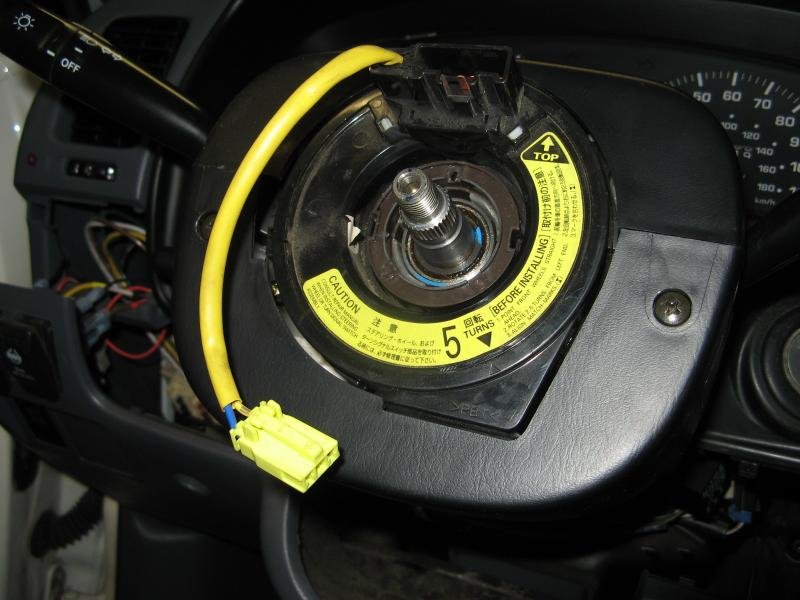

    Yellow shrouded wire looms and connectors are SRS, there's a few yellow wires in a main harness but not many, and its best to be careful.
    The practice to disconnect the battery is a good one, but all you have to worry about is the big yellow connector that's revealed under the steering column connector.
    It's rare to deploy an airbag, you need to induce voltage to it and you are trying to take voltage.
    The worst thing to do is tilt the SRS ECU while the battery is connected, this convinces it of a roll over. This is also rare, and you won't be anywhere near it.
    Yellow means bad, just avoid them and you'll be fine.
    Also a note, most SRS connectors have fail safe connectors that require a slide action to disconnect, just to avoid any confusion.
    just a picture of a yellow SRS loom.
