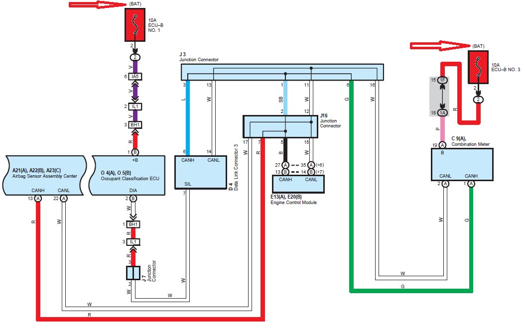

    The vehicle has a few systems that are always juiced. Unfortunately, you messed with one that is critical. Maybe it'll clear, my guesstimate it won't. :burp:
    PSA_FYI-Ground terminal from battery
