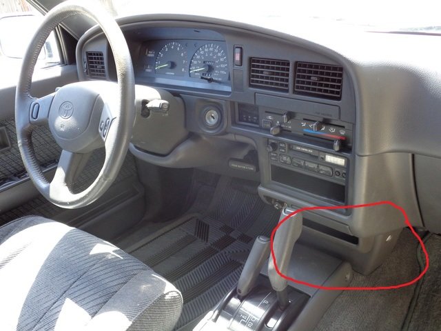

    code 12 means short in D squib circuit to B+
    code 31 means a malfunction in the airbag computer
    D squib circuit components are clockspring, steering wheel airbag and the computer, so one of these has gone bad. Though, combined with code 31, it likely means it is the airbag computer...
    it is located right in front of the transmission shifter, behind the panel that's below the dash panel with the radio. Just undo the two clips on each side and you'll see it
    you could try checking your clockspring, just in case, but a tell-tale sign of a bad clockspring is horn or cruise control problems, especially as the steering wheel is being turned

    oh, no, it's not the interior of my truck on the picture. But still, mine is as clean as this one. I do have a boot for the 4x4, too
