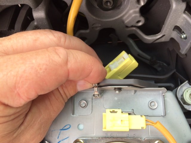

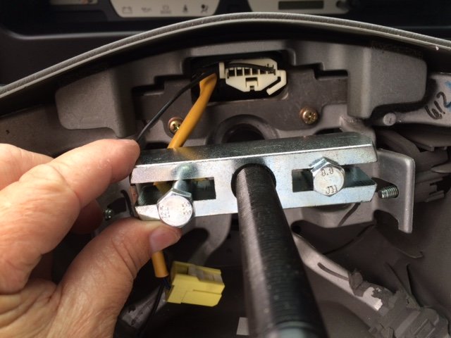

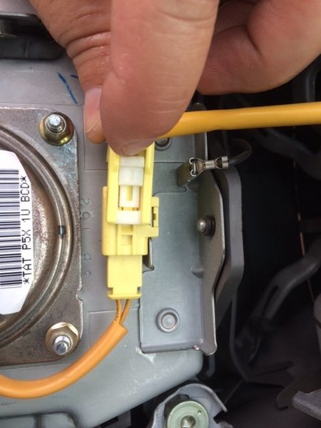

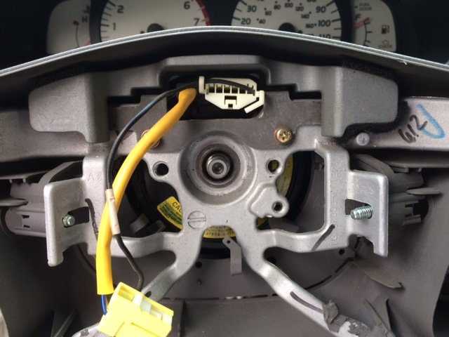

  5. Oct 28, 2015 at 5:20 AM
    Ritchie
    Ritchie Well-Known Member
    Dec 24, 2012
    #93649
    1,931
    San Diego (North County)
    RC Step side Pre-runner
    2.7 w/auto, 4WU 3 link, F & R Diamonds, ARB's F/R w/ Yukon 5.29's, Inchworm 4.7 Lefty, Deavers, ARB OBA, Schrockworks up front.
    Question: Have you been through any mud lately?
    If so, as a suggestion, disconnect the negative cable from the battery, then check/ clean the sensors on the inside frame rails towards the front... mine are yellow. That may be causing some issues, dunno.
    If you need pics of the actual air bag assembly, I have a few as I just replaced my steering wheel on Sunday.
    Let me know.

  9. Oct 28, 2015 at 3:28 PM
    Ritchie
    Dec 24, 2012
    #93649
    1,931
    Here you go, very straightforward.
