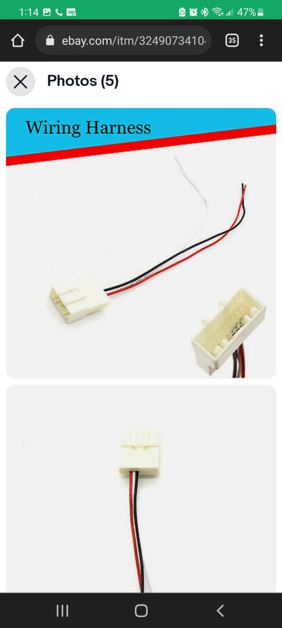

    So, the truck will read the extra switches. You must have, if not already equiped, the clock spring from a model that came equiped with 1 or both switches. I fully converted mine from a model with the base radio and no switches. Once i got clock spring and swithes in. I had to purchase a small radio harness for a another toyota, or lexus model with steering wheel switches. The harness is only 3 wires, (Rx, Tx and ground) our trucks are prewired from the steering column to the harness behind the radio. The connector for a radio that utilizes steering wheel controls was already on the dash harness behind the radio, unused, on my base model. The andriod radio in my truck was able yo utilize all the switches once i added the toyota/lexus radio harness from ebay and i could program all of the switches to what ever i wanted. They also seem to get their illumination power from the radio as well. Soon as i hooked it up. The steering wheel controls started to come on, as they should, with the parking lights. Prior to plugging the radio control harness into the radio, the switches and clock spring were already done, but would not light up until i finished wiring them to the radio. I may have had to re-pin the connector to work on my truck, but it's only 3 wires and easy to figure out. the important part was it had the same connector.

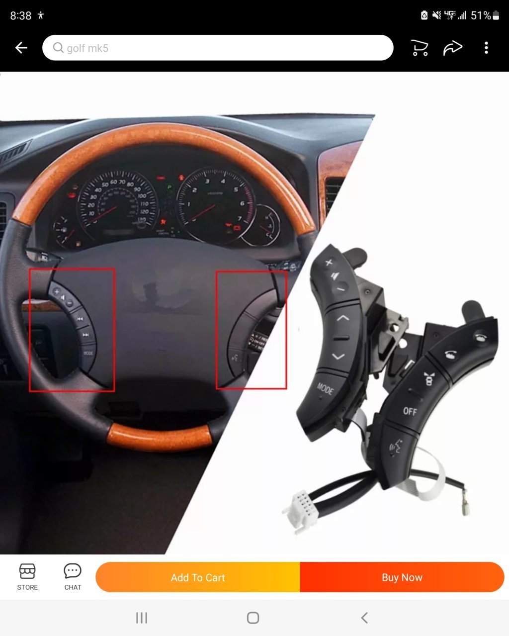

    I'm talking about the adaptive cruise switches in the middle of the right hand side... the other ones I know will work.
    I did find an aliexpress dealer that will sell me the airbag cover.

    OH! looks like you got some controls for another vehicle with the same steering wheel. These trucks never had adaptive cruze control. Yup. On a Tacoma control like the one you've shown it is actually blank on those two buttons only.

    Think that's what goosie was saying. I actually ordered without.

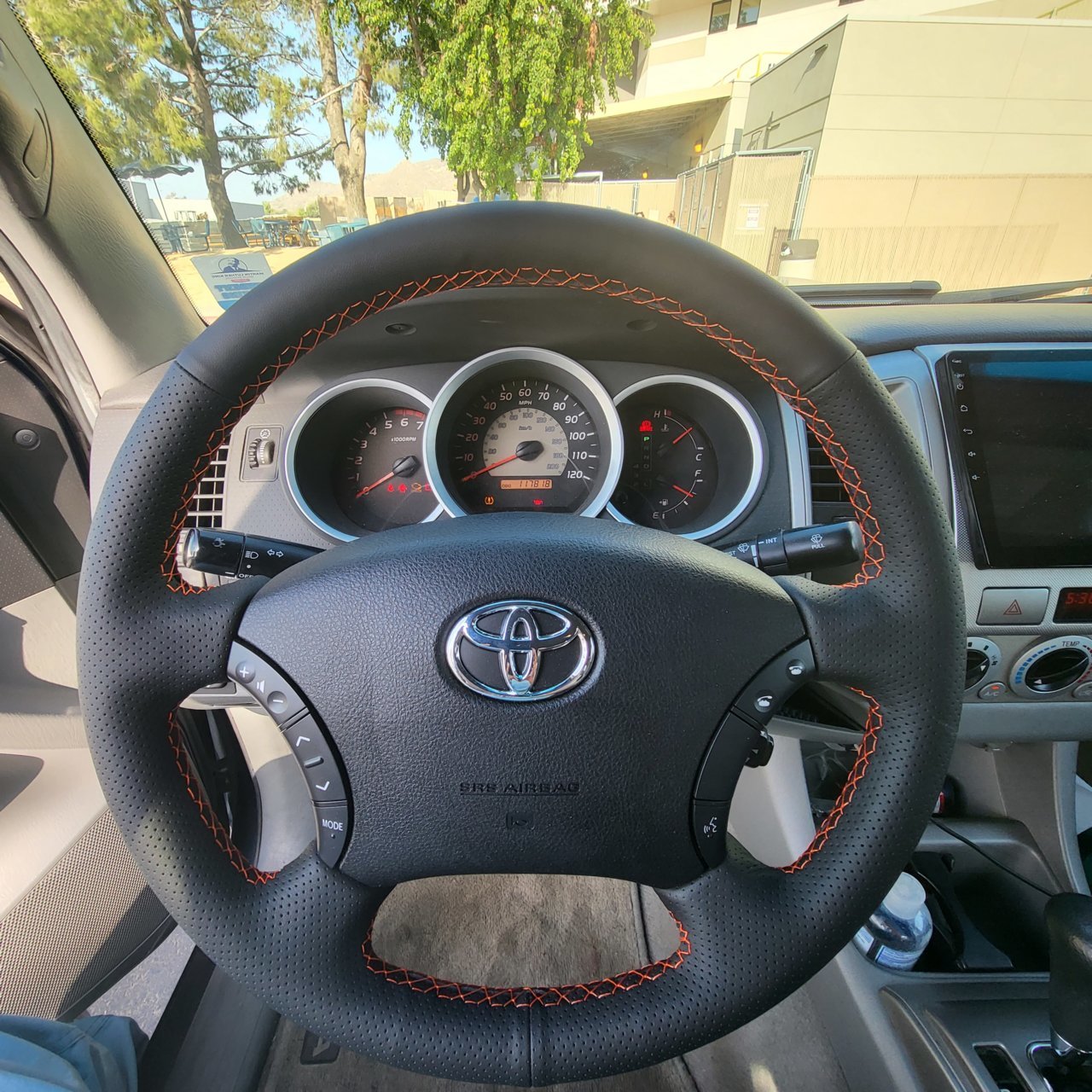

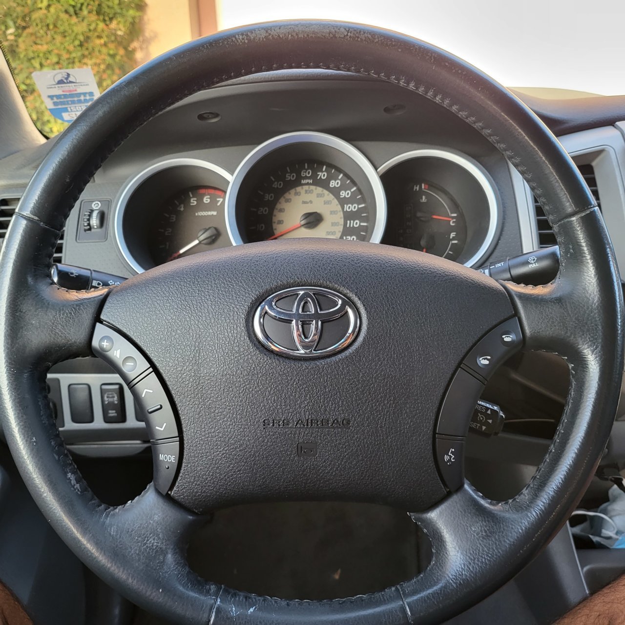

    Less than $100 for airbag cover, buttons, and clockspring.
    Without a doubt the hardest part was getting the original airbag cover off. The massive head rivets were a pain to remove.
    My old wheel looks crappy compared to the new cover!

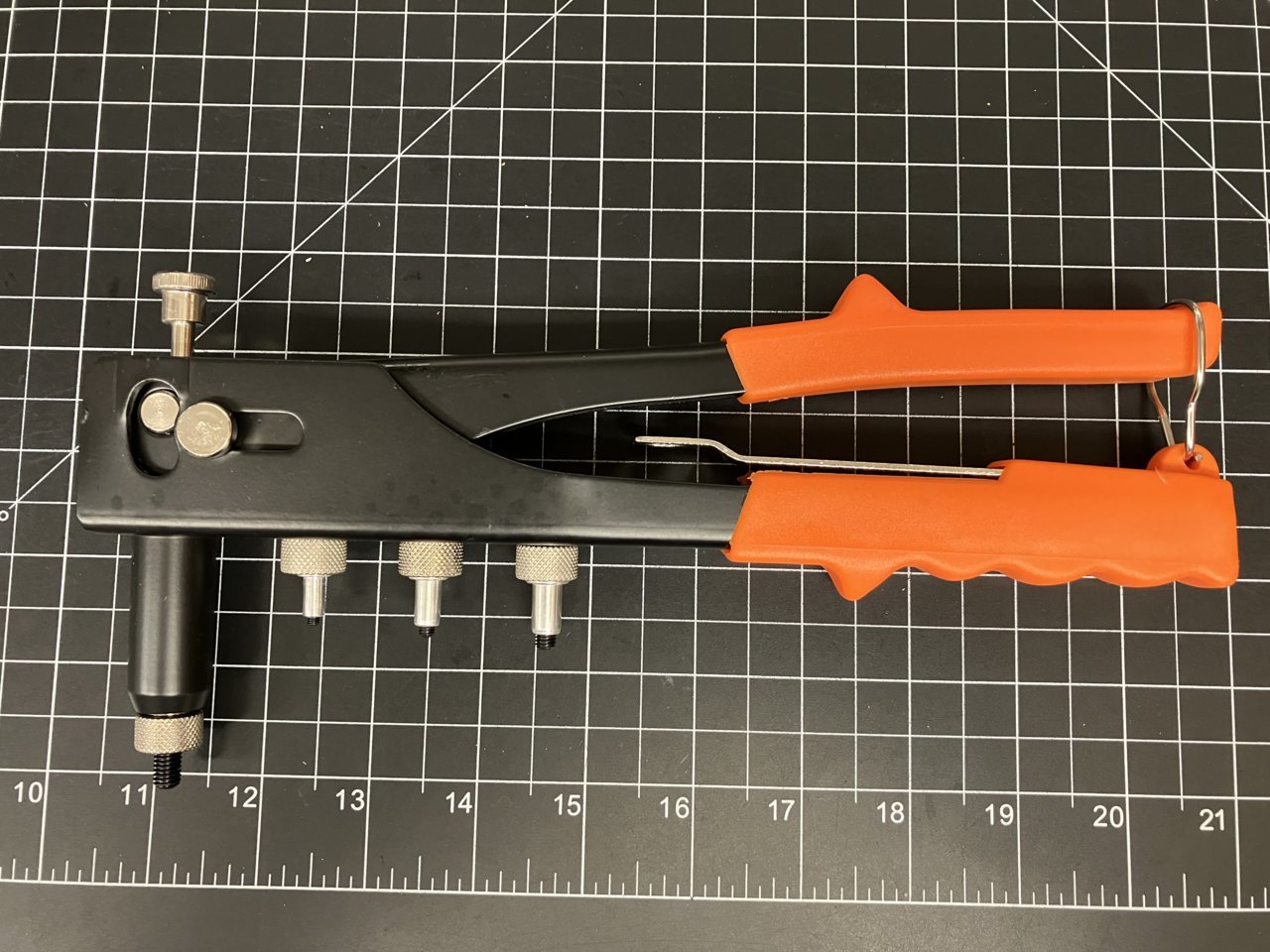

    Any help on a good rivet tool? I've never done any. Hunting for a cover, bought a wheel and clock spring but my bag is a single stage so it's gonna be dicey...

    Best $5 you've ever spent! I found a place on aliexpress that sells the covers.

    I guess it's an assumption as it's a 2002, I have yet to open it up so we'll have to see. Thanks for the info and leads, much appreciated!
    I wonder what this guy is, looks similar but has threaded pieces. Rivnut tool possibly?

    That looks like a threaded insert tool

    I ordered up a rivet tool, at least I have that part covered I hope.

    Now the steering wheel is done!

    That wheel looks great!
