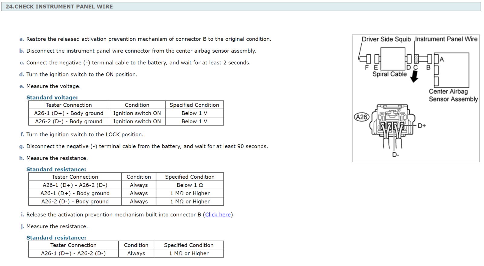

    That "wire" is the harness that plugs into the center airbag sensor assembly.

    So I used the multimeter on what i believe is the D+ D- terminals and I have 3.5 ohms with the meter connected to both terminals. O ohms when I test each terminal individually to body ground. I saw prior posts questioning what is the "activation prevention mechanism," and i confirmed that is the tabs you need to stop from grounding in that instrument panel wire connector (big yellow plug going into airbag sensor assembly). I used the tip of a zip tie to stick in there and stop the connection. I saw something about using paper to shove in there and break connection but i needed something firmer.
    So i'm guess the 3.5 ohms means i have a short somewhere and thus the codes 51 and 53. Not sure what i need to replace. I also worked on the code 74 issue which concerns the passenger side pretensioner. I don't find any short in the two wires going from the airbag sensor assembly plug to the pretensioner. I saw another posts where the pretensioner connector was damaged but my connector appears fine. Ohms seem to be in spec so no idea why have that code 74. I'm kinda at a loss. May plan a trip to the salvage yard and see if i can find a complete airbag sensor harness.
