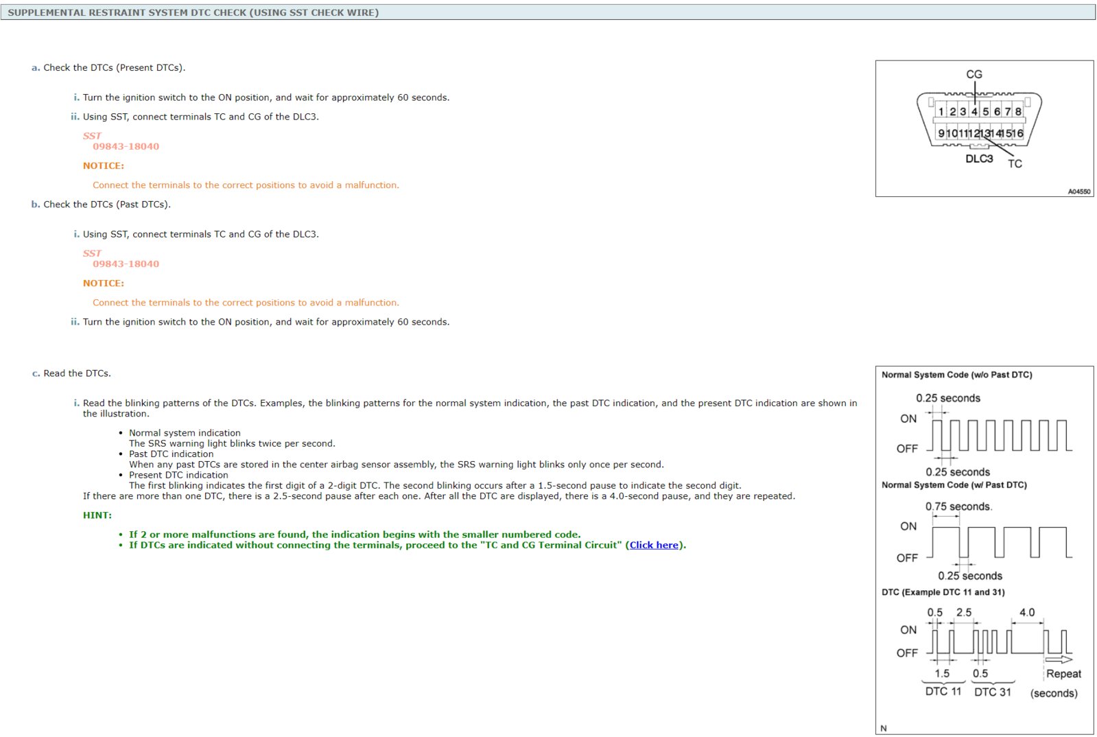

    You could check it via the on board DTC method.
    But it can be aggravating. I'd personally just take it back and ask them "NICELY" to look into the issue.
    Should you want to do the "Poke and Count" - Here is the "How To" (Not worth your time)
    Count the lights and give us your code. We can then tell you what the code is for.

    This is interesting! I could probably build my own test wire...

    paper clip, bread tie wire.....
    Doesn't have to be anything special

    Just don't go shoving it into the terminals and spread the terminals in the OBD port.

    Getting the codes is step 1 in troubleshooting, once you have those then we can move on to checking/testing. Otherwise we don't know what to check/test.

    I have some deutsch connector pins that look about the same size as Toyota's tool.
