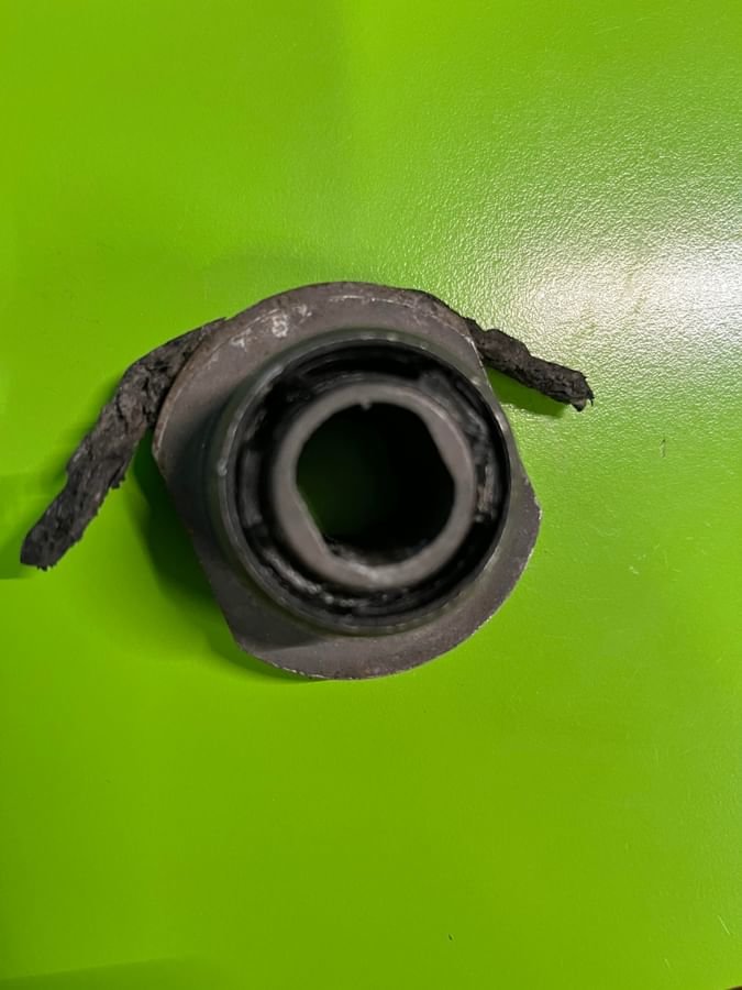

    Rock Auto steering rack that I installed:
    https://www.rockauto.com/en/moreinfo.php?pk=13067317&cc=1432865&pt=7388&jsn=408
    The work all started because of the crappy bushings (see image) on this cheap rack I installed were throwing out the alignment. Originally they were going to replace just the rack bushings but they said it's an oddball an that OEM replacement Toyota bushings won't even fit.
    Short story long at the end of the visit they said that it probably failed because of whoever (me) installed the rack before had pulled the steering wheel over too far? This is a confusing statement to me.
