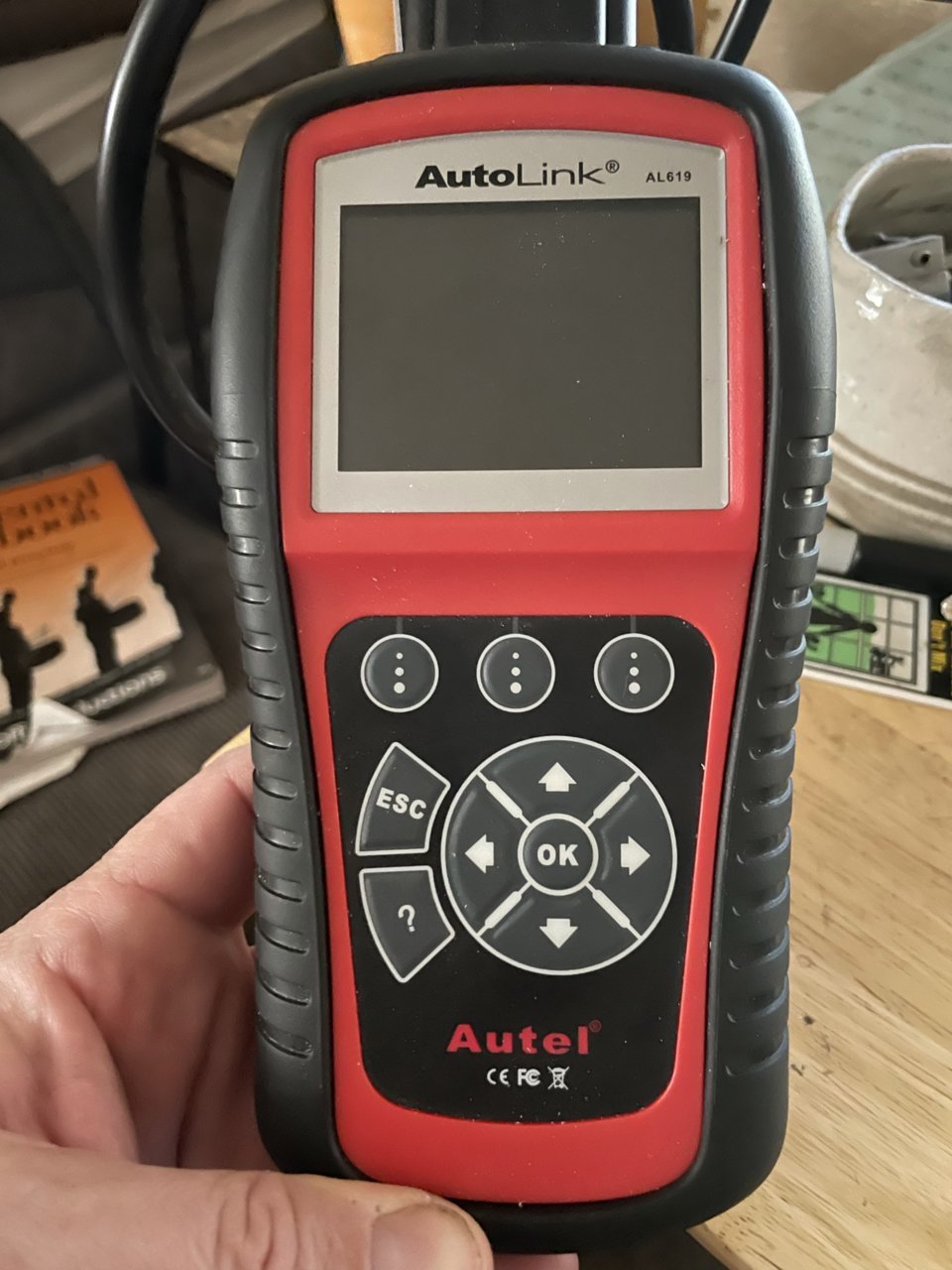

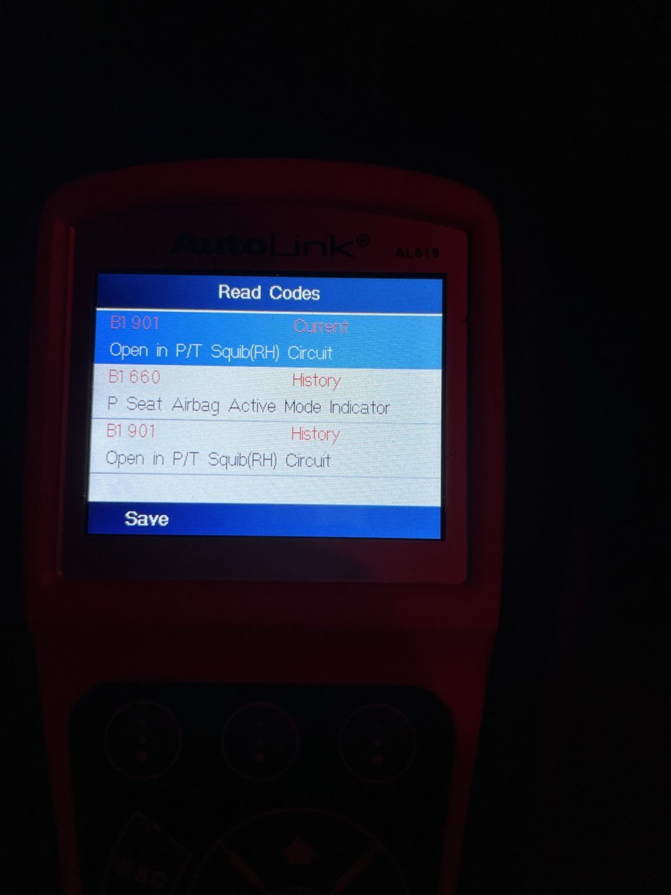

  15. Jun 24, 2021 at 8:24 AM
    EricT
    EricT Well-Known Member
    Jun 1, 2009
    #17887
    929
    Arizona
    '09 4x4 shortbed TRD Sport
  16. Jun 24, 2021 at 8:30 AM
    #16
    ThatMattGuy
    ThatMattGuy [OP] Well-Known Member
    Oct 10, 2013
    #114227
    109
    Matthew
    Lenoir City, TN
    13 White 2WD Reg Cab
    So the codes suggest harness or wires for seat belt on passenger side. I would assume it would be the harness that gets the signal from the buckle as opposed to the one on the back pillar where the seat belt lives. So I would take the seat out (I had a bench, that sucks to remove), flip it over and just trace wires and look for scrapes where the it can short out. And I would reseat anything I saw.
  17. Jun 24, 2021 at 9:11 AM
    #17
    EricT
    Jun 1, 2009
    #17887
    929
    Arizona
    Really, that's the passenger seat? I thought it was the drivers side. I'll pop the seat (buckets, 4 bolts to freedom) and reseat everything and test it out. About to go yank off my anti sway bar anyways!
    https://www.autocodes.com/b1901_toyota.html Edited to add this - why I thought it was driver side. Still think it might be, thoughts?
  18. Jun 24, 2021 at 9:26 AM
    #18
    ThatMattGuy
    Oct 10, 2013
    #114227
    109
    Matthew
    Lenoir City, TN
    Just went back and checked again. Its drivers side. I misspoke. Sorry about that.
