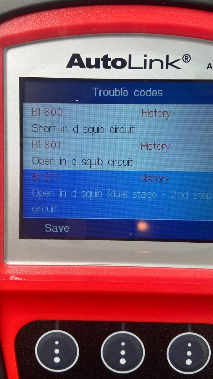

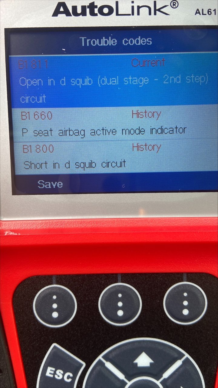

    Here are the codes I have
  18. Mar 24, 2023 at 7:04 AM
    #18

    All those point to a bad clockspring except the B1660 but it's history so maybe it was a one time event.
    TnShooter and Steves104x4 like this.
  19. Mar 24, 2023 at 7:22 AM
    #19
    hennessy3300
    hennessy3300 [OP] Well-Known Member
    May 11, 2019
    #292960
    97
    I did replace the clock spring a few years ago with a cheap ebay unit. Hopefully that is all it is. The horn and cruise control work fine though.
