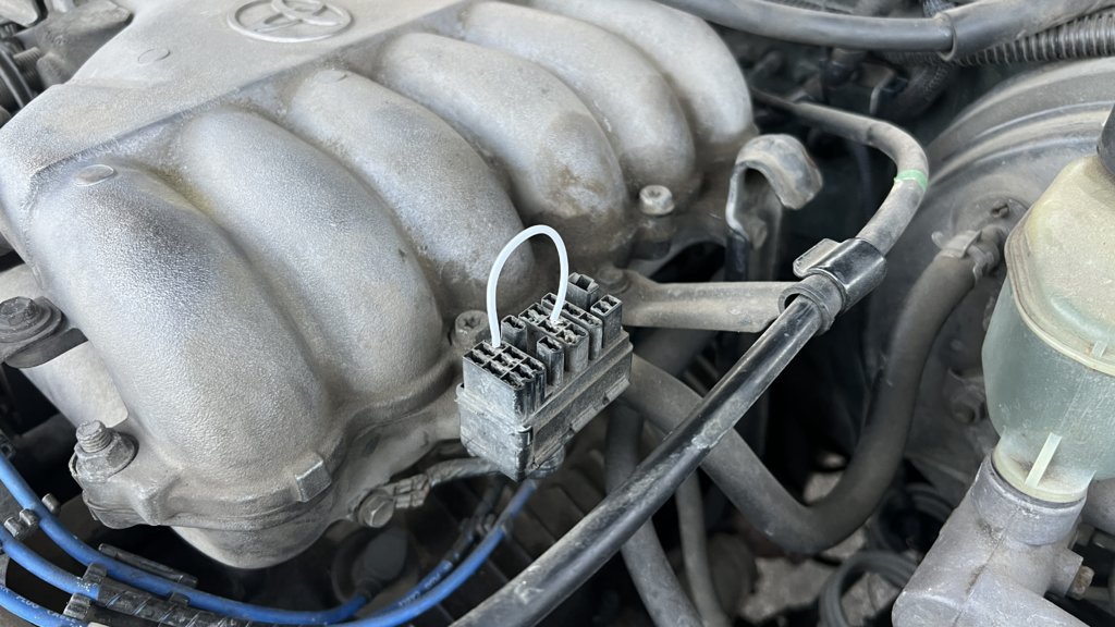

    If they didn't tell you, you can pull the error code yourself. You can do that via the DIAGNOSTICS terminal in the engine bay. Put the keys in the ACC or ON position and wait for 30 seconds then short the pins Tc and E1 (the diagram is on the inside of the cover when you flip it open)
    The SRS light will blink in a pattern, telling you the code.

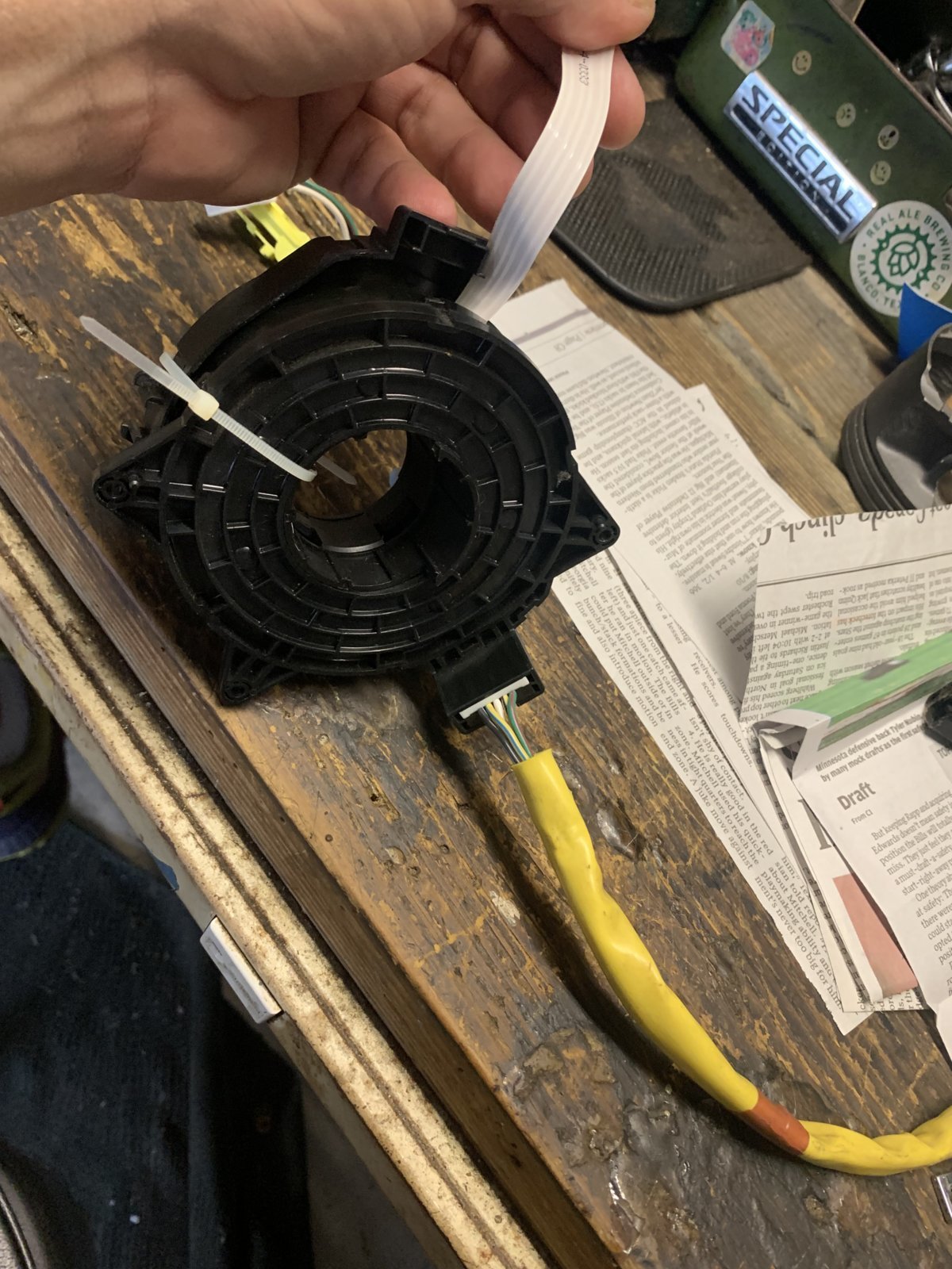

    IMG_4163.jpg Bjartur
    I just went through this situation/issue with my Subaru last week
    Turning steering wheel sounded squeaky in certain places
    Cruise/horn worked
    AB lite on
    Once I connected/read flashes, explained
    That multiple ABags needed to be RR-d and clock spring needed
    Car worth $2k(not buying $1k airbag(s)
    Replaced clock spring
    Reset system per diagnostic port
    Good to go

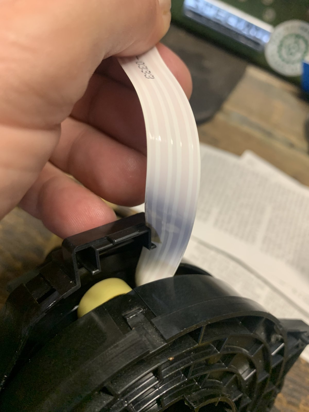

    So here is a pix of a clock spring ribbon
    Inside the ribbon there are wires
    In my case(kinda like yours) horn/cruise ribbon wires in tact. The AB signal wire was compromised.
    So we were lucky that CS partially failed

    Clockspring issues can be tricky. Sometimes they are obvious (problem arises or goes away when turning the wheel a certain way) and sometimes they aren't. Good to know you fixed it with a new clockspring :)
    The damage is the white spot, right? What kind of damage is it? Looks like it's internal as the white plastic layer is not worn through
    Or it's an air bubble maybe? Did you test continuity in the affected wires?

    Dang
    I didn’t even realize/see that!
    Nice eyes fur sure
    I did do tht continuity test
    It passed 8 out of 10 times
    Ugh
    I bit bullet and sourced one

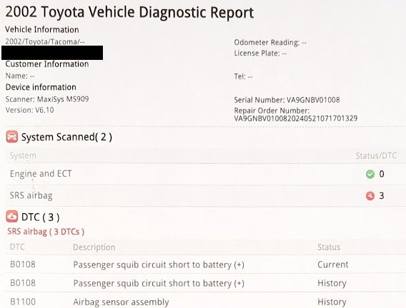

    Thanks for the responses. I went for a second opinion/inspection and they passed it with the light, so there's less urgency now, but I'd also like the passenger airbag to work if I needed it (and not go off when it shouldn't). They at least provided the codes.
    I also had the battery checked and got the thumbs up, but I can't really say I was super confident in the AutoZone guy who tested it. The posts look clean, but the hold-down has some corrosion on it. I'll go back in and check the + wire next, but I'm probably still hosed if I can't get the code cleared...

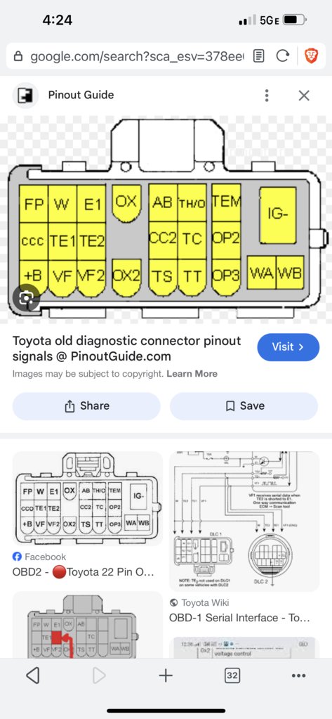

    Having an issue and I jumped the terminal under the hood like @onakat said. TC and E1 and followed the blinks of the airbag light. The blinks Im getting are 1 pause 4 pause 5 pause 4, so 1454. Idk where to find what this is.
