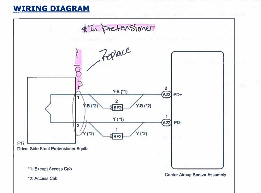

    For reference, I uploaded the .pdf i found on another post of the B1900 troubleshooting tree. That post was an 06 i believe, i don't know how different the process would be for an 11 but this is my thought process.
    The way I read this, for B1900, is below:
    -check connectors for damage/loose
    -check the No 2 floor wire for the short by disconnecting both ends (check easy/cheap stuff first, makes sense)
    IF OK
    Check the airbag sensor
    IF OK
    Check Outer Pretensioner
    This leads me to believe that if this tree was followed, the airbag sensor would have been cleared prior to replacing the tensioner. So the fact that the tensioner was ID'd and replaced and THEN the center sensor was ID'ed as faulty doesn't line up with how I would think this system would be troubleshot. Even if this isn't the exact procedure, based on this methodology I'd imagine the source could be isolated to one or the other and narrowed down more than it was.
    Sorry this is turning into more of a prove the dealer wrong type of thread but hopefully someone can pull some insight on the troubleshooting procedure from this in the future and/or help fill in any knowledge gaps or correct assumptions I'm making.

    Essentially it's the same steps if you follow the flow chart.
    I think what I would do is with the key off unplug the seatbelt pretensioner, manipulate the vehicle side harness connector so the shorting bars aren't shorting it out, turn the key on, and see if B1900 goes to history and B1901 sets as current.

    Thanks for this! I definitely plan to do some of my own diag when I get back into town tomorrow. In the meantime i've been going back and forth with the dealer and managed to get a little more info out of them, but still nothing that proves the pretensioner bad vs the ECU. They sent me a notably abbreviated version of the doc you posted and this was listed in there, not part of the procedure, but just noting that they probed the pretensioner and measured 100 Ohms so, there's your short and we'll replace that before checking anything else. Has anyone probed these before? From what I can read online it seems like a good resistance is 0-5 Ohms but also lots of mixed reviews on DONT APPLY LEADS to the pretensioner for fear of setting it/the airbags off. Either way this doesn't seem to add up to a short in the pretensioner.
