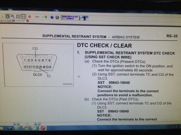

    Yes, or you pull them by jumping the wires on the OBDII connector.
    Then watch a sequence of flashes at the SRS light.
    It can be a bit tricky if you’ve never read codes like this before.
    Before you start, you need to understand there is Past and Present codes.
    (You’ll want to start with present codes, if that doesn’t work go to Past)
    For present codes, you connect the jumper wire after the ignition is turned on.
    For Past, you connect the jumper before the ignition is turned to on.
    Other than that, the process is the exact same for both sets of codes.
    I got the picture from here, feel free to read more about it there.
    https://www.tacomaworld.com/threads/air-bag-light.300182/
