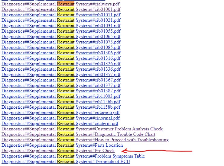

    Unfortunately, a simple code reader option is not available for 1st gen Tacomas with SRS.
    You need to find a digital copy of the FSM. There are links floating around here if you search.
    There are many pages dedicated to the SRS, but the page on how to read potential codes is the Pre Check page. Similar to the ABS codes, you have to jump two pins, read out the light blinks, and then follow the procedures on the other pages.
    Doing anything with the air bag system should be done carefully- you don't want one to go off in your face accidentally.

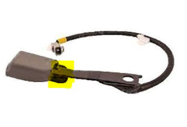

    Get it scanned somewhere! My 2015 Tacoma had the SRS indicator light turn on just last week. After scanning, turns out the passenger seatbelt switch was bad. I removed it and there is a little transistor on a circuit board that died. I found an OEM replacement for $35.
    The bad transistor was inside the highlighted cover. $35 included everything in the picture. Anyway, getting it scanned is ideal as you should be able isolate the issue. There's a lot of little electronics that could potentially go bad, even in a 1999 vehicle. Best of luck.
