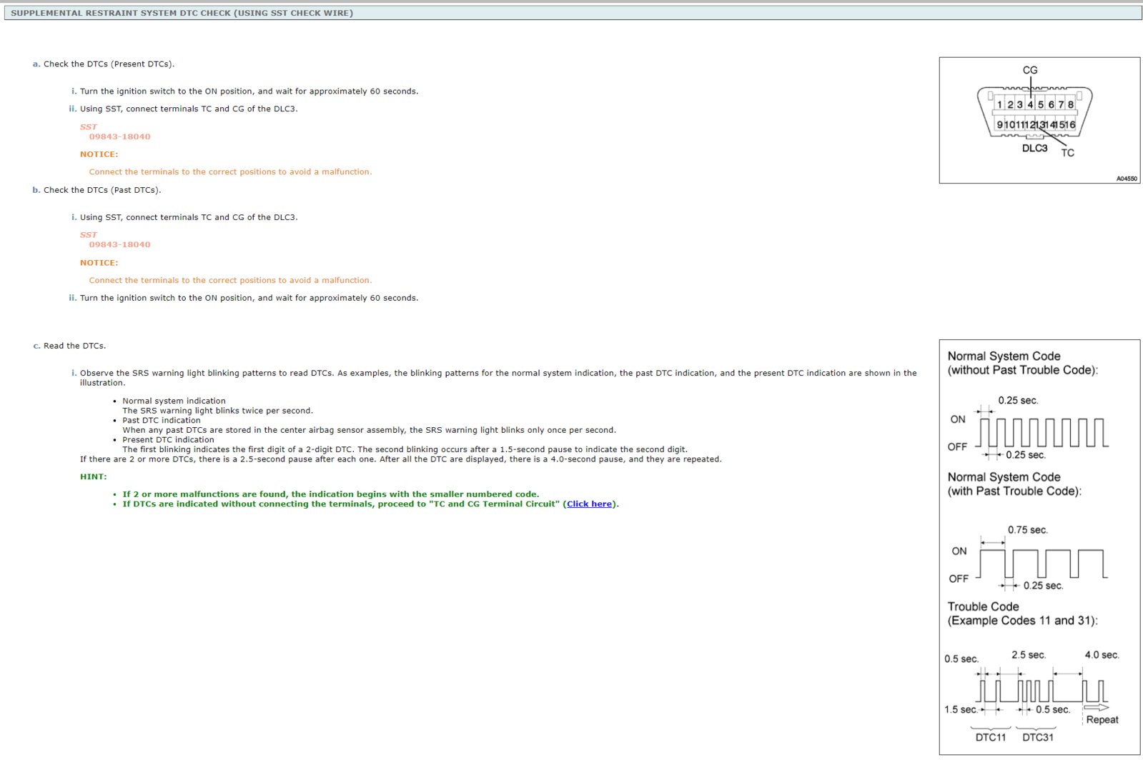

    You can pull the SRS codes yourself.
    It helps if you have a little experience reading them before.
    Wort case, you can video it. And we can tell you the codes.
    But it would be a lot easier with a scan tool.
