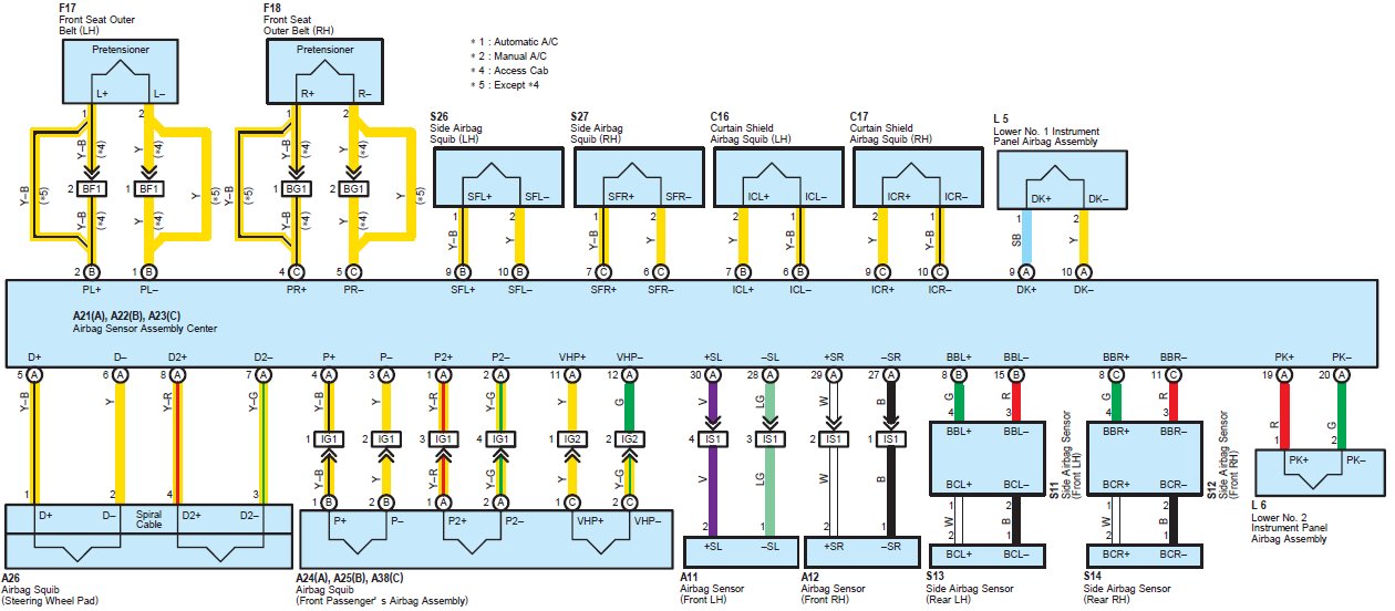

    I did not include the Occupant Classification ECU...

    I have a track car that needed to have airbags removed as part of track prep. It was very straight forward. You will need to know the resistance across the airbag circuit -- you can measure this or someone might be able to give you can an idea of the values. Purchase the correct value resistor and add it to the airbag circuit. In my case, I've added a 2amp mini blade fuse to the circuit as well -- if for some reason the air bag signal is triggered the fuse will act as though the airbag fired.
    If you need further details, let me know.
