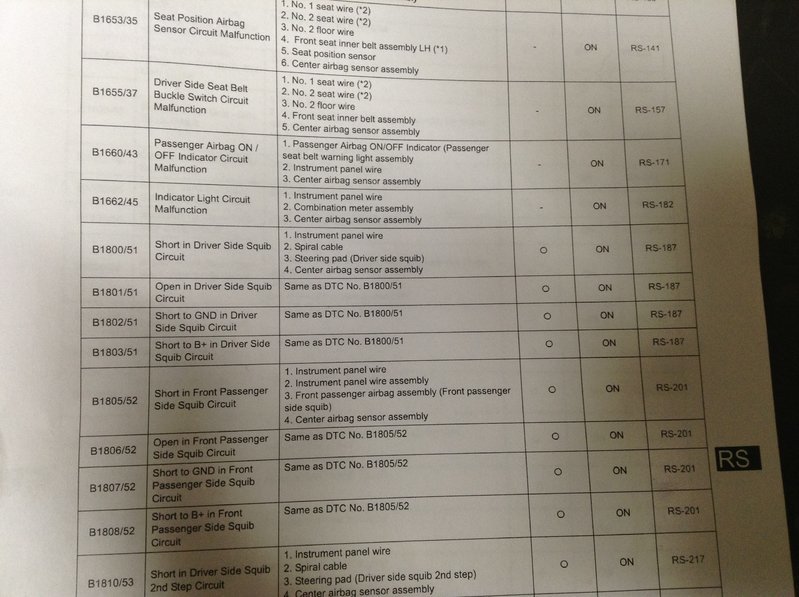

    image.jpg So 51 could be 4 possible things. I thought the open on the orange connector was the problem. Do y'all know if the problem was fixed with the new clock spring does the fault just clear or do I have to have a diagnostic tool reset it?

    You do not need to reset it. If the problem is fixed, the SRS light will turn off with the rest of the gauge check at start up.

    Those connectors are very touchy. The ECU checks for continuity of every sensor/squib on start up. If the resistance is wrong, you get the light (code 51).
