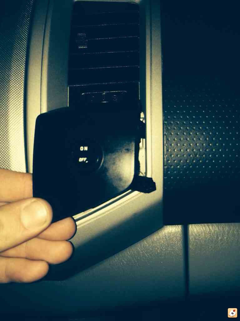

    So the previous owner of my truck installed a fm modulator for iPod. He took the passenger airbag switch out and put in a on/off switch for the modulator. I do not have the airbag switch but the wires/plug that use to go to the airbag switch is there. I need to get the passenger airbag working again because right now it is off all the time. I have thought about cutting the plug and using the on/off switch that was controlling the modulator but when I try to jump the two wires in the plug it does not turn the airbag on? Shouldn't connecting the two wires turn the airbag on? Need some help if anyone knows a direction for me to go here. Thanks

    I think it has to be closed and a weight in the seat before it turns on.

    I tried to seat in seat and jump the two wires. Does the oem switch have something special?

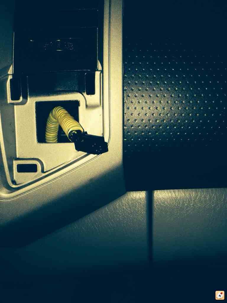

    Great info guys. What is the wire pictured here?

    The wire pictured is for the on/off switch, but as previously stated, those only come in the single and access cab models, not the double cabs.

    So there was no switch when it came stock? The wire is just there for know reason? Not that I don't believe it but that seems strange.
    So if my passenger airbag is not ever turning on when someone is sitting in the seat I have a bad sensor? I presume this is what you are telling me and I am doomed to the stealer/dealer. Dam I hope not

    Yes, the wire is there for no reason from stock. Why make multiple harnesses just for 1 plug being unused?
    As for your question, there could be 1 of 3 likely issues with the system.
    1ST: the Occupant detection ECU which is under the seat might be bad.
    2ND: it could just need to be recalibrated.
    3RD: the seatbelt buckle may have a problem if its not detecting that the seat belt is engaged.
    Hopefully this helps a bit.
