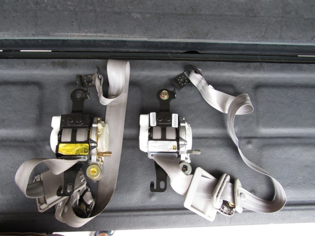

    I just replaced the seat belt (w/pretensioner) on my 2001 Tacoma with a brand new OEM one from the dealership. The part number for the 01 was discontinued but there's a newer part number for the 2004 that looks identical (73220-04141). The local dealer parts guy agreed and ordered it in. My old one on the left, new one on the right.
    The only reason I replaced it was because the spring tension to retract the seat belt was getting weak. However after replacing it, I'm now getting a slow flashing airbag dash light. Since the connector is a special SRS (supplement restraint system) connector, it has the additional snap clip that goes over the electrical plug. It snapped into placed so it seems like that connection wouldn't be suspect.
    Has anyone gotten a new seat belt that turned out to have a bad sensor for the pretension (the explosive charge)?

    bc of pretensioner and yellow(brown in your pix)pigtail on new belt, the air bag system detected a fault. Tosses AB lite.
    Dont think u got bad belt
    Just need to reset AB system
    it’s not too difficult to reset
    now I haven’t done/reset Toy AB lite
    But lots of experience with 2001 Subaru systems……bc of year/technology at the time will be “similar “
    on a subie, have to find a friction taped up portion of harness usually under steering wheel/knee bolster
    Unwrapped, there is a female pigtail (like 6 pins)and then 2 male test connectors
    you plug in the 2 male test connectors in specific pins on the female pigtail
    Then turn ign key…. The AB lite will flash a Morse code for the fault.
    Once read, you place the male test connectors into different pins to clear the code with a specific AB flash pattern that signals you that codes are clear and functioning
    that’s a thumb nail summary
    but would need to get Toy FSM for exact directions

    So I think what happened is possibly a mismatch in the plug that goes into the pretensioner socket. Unfortunately, the dealership parts guy and myself were a little to eager to use the part number that didn't specifically say it fit the 2001. When at the counter he read off what the part number fit. It said 2000-2004 'except' 2001. Not kidding, but he let me check the new belt by taking it out to my truck and the pictures I took earlier and it's pretty much identical except after fussing all day I noticed that the plug didn't fully bottom out in the socket.
    The new one on the left has a very slight raised part if you notice the two pins on both have a 'shorting bridge' (brass tangs that touch the to post contacts). That shorting bridge keeps the pretensioner pyrotechnic safe from voltage until the plug is fully seat and you engage a little black cap that's a part of the plug (push the plug on, then push down on a little plastic part that disables that shorting bridge).
    I think what happened is my plug doesn't bottom out (there was still about a 1/16th gap where the plug meets the socket), I'm sort of assuming it was not breaking that shorting device. I put the old one back in for the moment, reconnected the battery and the airbag light immediately went out, as normal. Think I may have to go to the salvage yard and find that pigtail and maybe splice it in.

    Pretty weird that the part number of the seat belt I got actually says it's for year models 2000, 2002, 2004 but skipped mine, 2001. Can only guess why Toyota skipped it. I initially thought it's just a plug difference but it seems possible that internal resistance of the pretensioner could be different too. Toyota!!
    For now I'm going to use the old one since if I am able to return it I won't have modded it. I'll use the UHMW Polyethylene tape over that upper turn buckle to make the belt slide easier and look into it more.
