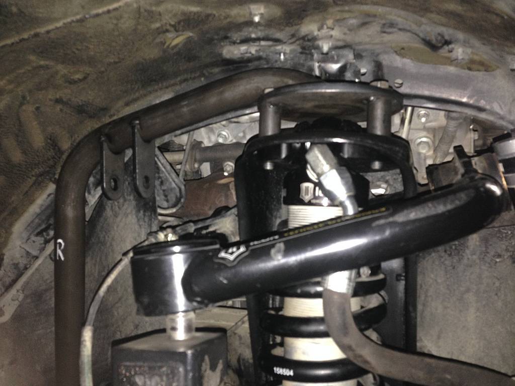

    Top hat on my right shock was broken.
    If this matters at all, the spot where my top hat broke is not where they normally break. I went out to Icon to pick one up (it was covered under warranty...i love free!) and this is the first one they have seen where the bolt is sheared and the plate snapped at the rear hole. To me it looks like the bolt that holds the shock to the top hat broke and over time because of the broken bolt and the shock moving up and down the top hat was flexing and it finally snapped. I say that because where the top hat was cracked it wasn't a fresh snap it had been there for a bit. The bolt sheared right in the middle but still held the shock in place but did allow the plate to flex more than it should.

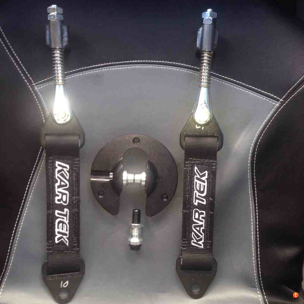

    Picked up some spare parts for my front shocks and some limit straps for the front so I don't have to use those spare parts.

    Where did you get the springs on the straps? I need a set of just the springs. lol

    The springs came on the clevis. Got them at Kartek offroad.

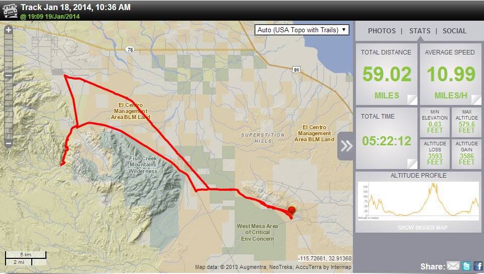

    Again it was cool to finally meet you man, truck looks even more beast in person! I saw the pics of fish creek? How close was that to our camp, I had no idea that was close by!

    30-45 minutes all off-road...

    Ya it was about a 25 mile drive to it. Here is the GPS track to it. Fish creek is the single track to the west of the map and running south into the mountains.
