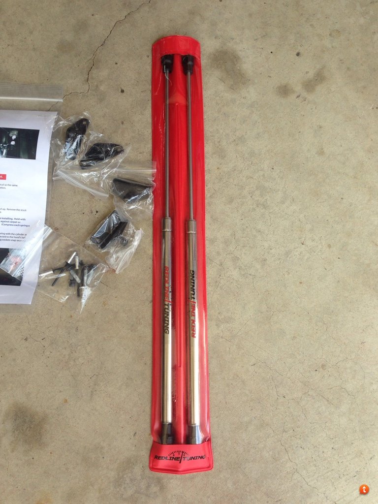

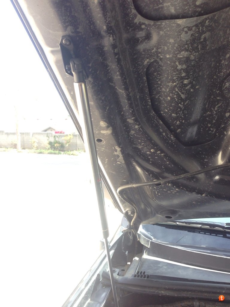

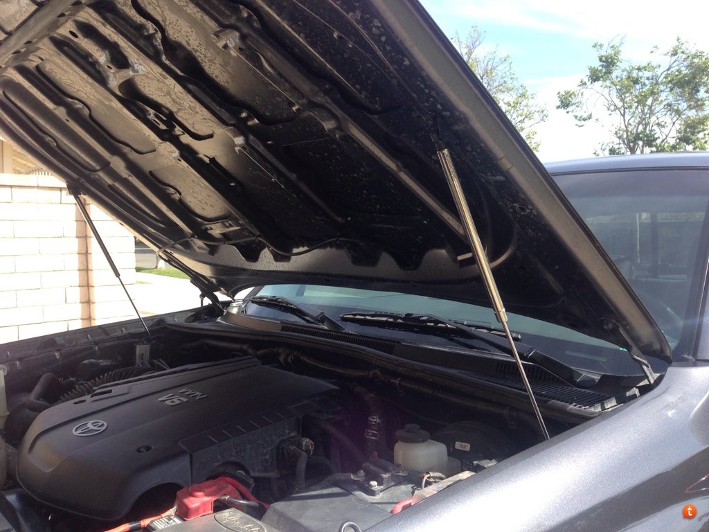

    Well I finally got my Redline shocks for my hood. This is a must have mod took about 30 minutes to do the mod.

    I had these. I loved them...They just wouldnt work with my fiberglass hood. They ripped right out of it.

    Nice choice on those hood struts. I need to put those on this truck.
