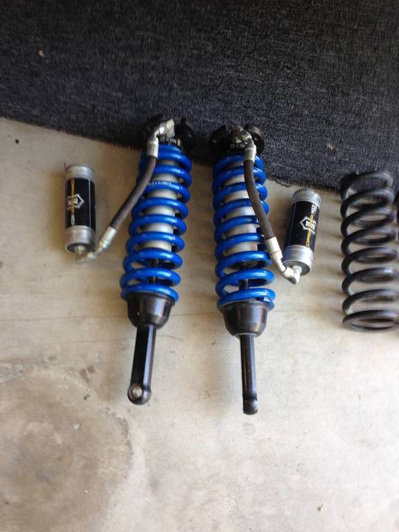

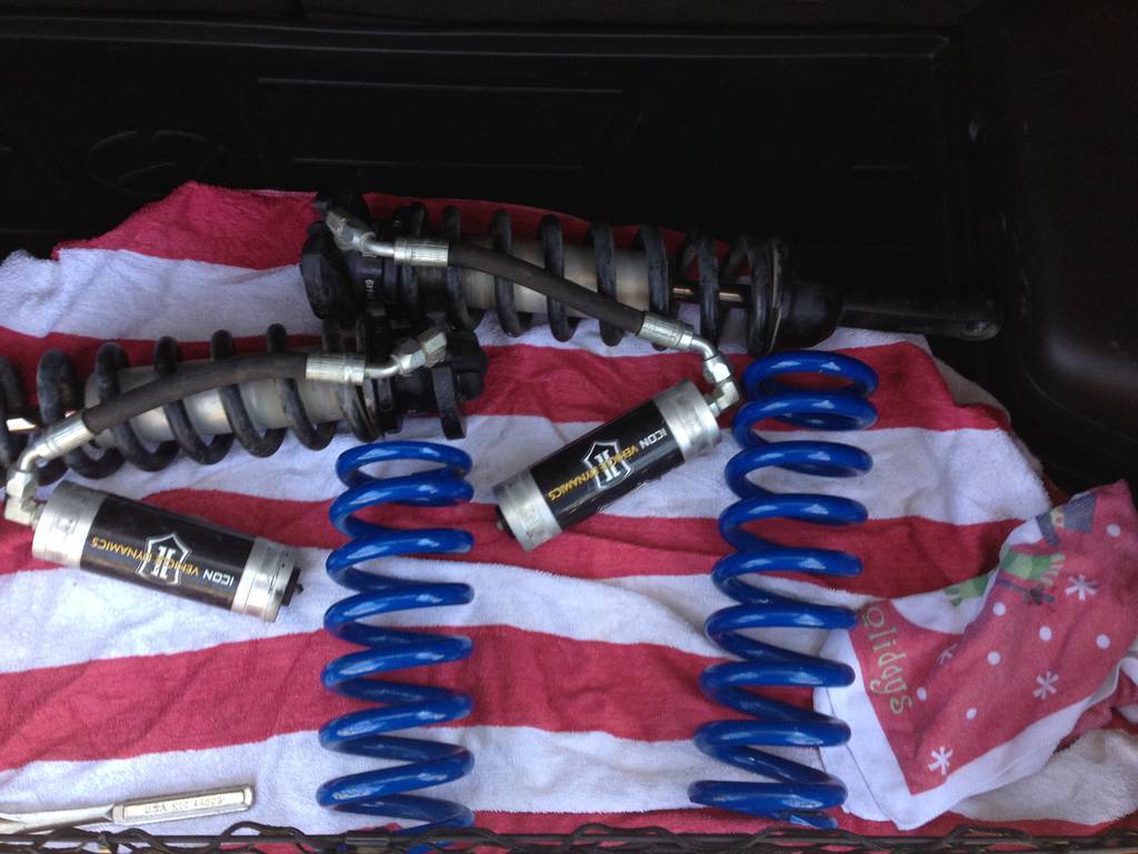

    Today I put on some 14 inch 700lb King springs to get rid of the massive amount of preload on the 13 inch 650lb springs that came on the icons, I needed the preload to keep my truck level with all the weight of the bumper winch and skid plate...and possibly my fat ass in the truck ;)
    Big thanks to 06Haole for the smokin deal on these used but almost brand new springs!
    Coilovers off and headed to the Goodyear about 1/4 mile from me who swapped them out for $50 bucks...not bad considering even with their wall mount spring compressor it still looked scary with all the spring pressure loaded up.
    New springs on old ones to the spare parts bin.
    All done and almost 0 preload. After this pic I put 2 full turns on the drivers side to compensate for the taco lean but it's showing maybe 2 threads now
    For comaparison. This is how much preload I had on the passenger side the drivers side had even more than this.
