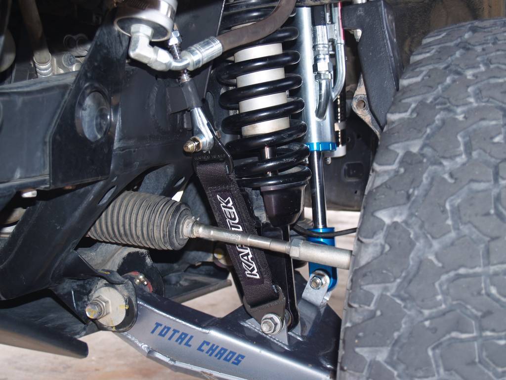

    will those limit straps work with the stock LCAs?

    SoCal
    https://www.tacomaworld.com/threads/airdogs-2012-prerunner-access-cab-slow-build.264263/
    Probably. I think you may have to weld a tab onto the LCA to attach the strap to.

    tab? it won't work like this on the stock lca ??[​IMG]

    i want to protect my next shocks and misalignment spacers , they seem to scrape the retainer clips

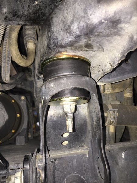

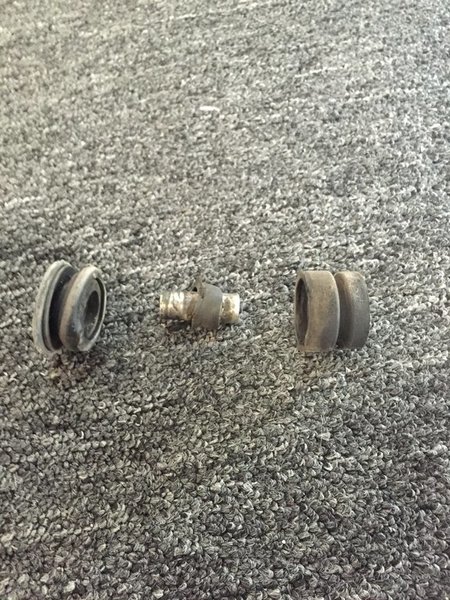

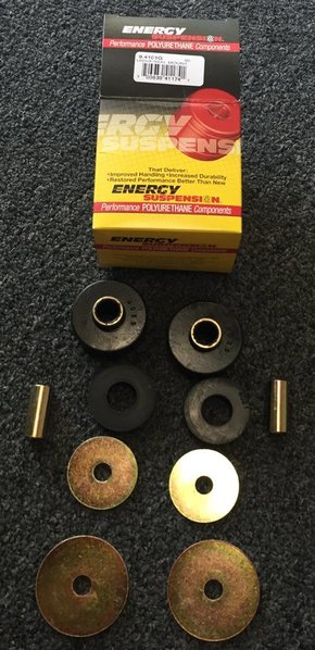

    Like everyone else that wheels my core support is cracked and not to spec anymore. Its caused my front end to shake and jiggle like a 300Lb stripper. The hood to fender alignment is a mess. So I decided to do a few things to save it till the future engine caging gets done. First is I stop drilled the cracks and riveted some sheet metal to help the core support from cracking any more. Sorry no pics of that but I'll get some one of these days
    Second was new lower radiator support bushings from Energy Suspension
    The stock pieces of shit all ripped and torn. They came off like this.
    The new ones installed. Though I ended up swapping the thick bushing to the bottom and the thinner one to the top. With the thick one on top it messed up my fender to hood alignment even worse that it already was.
