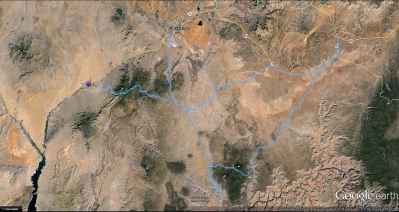

    Here's my planned route for the next 3 days.

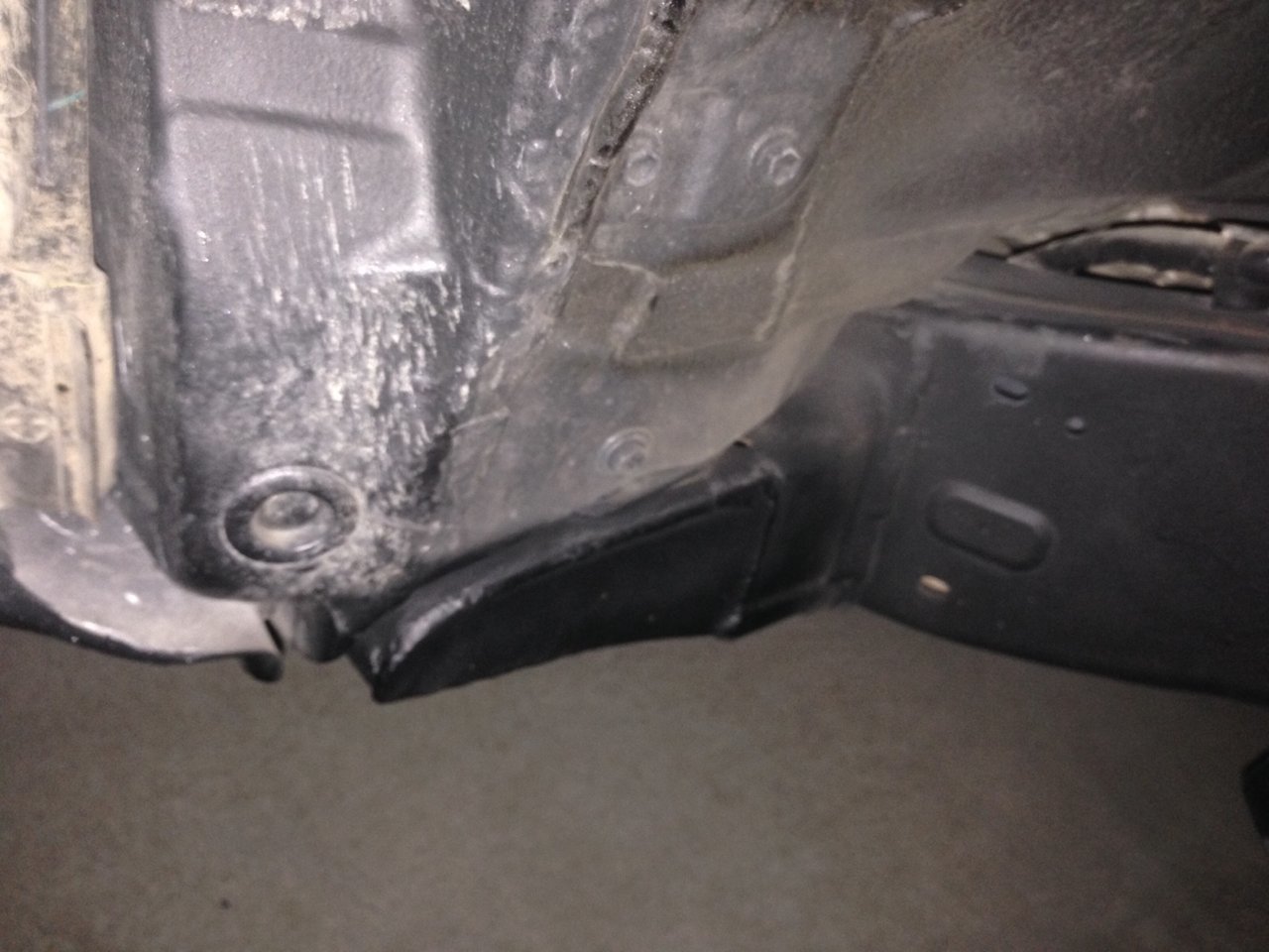

    So I see your headlights are broken as well, mine are broken on that same inner tab, I know how you run yours so it doesn't surprise m, but I gotta ask, what are you doing about the headlight/ rad support situation right now?

    First i'm sorry about the slow reply. Have not even looked at my own thread until today.
    As far as the core support is going i've done several things. Ive stopped drilled the cracks. Then i've sandwiched them in-between a thin piece of steel popped riveted together. In several places. I'll get pictures sometime of the repairs I have made.

    So how about the headlights and their broken tabs and all the flex the support still has? If you grab the upper support bar the one that runs along close to the mounting point of the hood, you can flex it with one hand no problem.

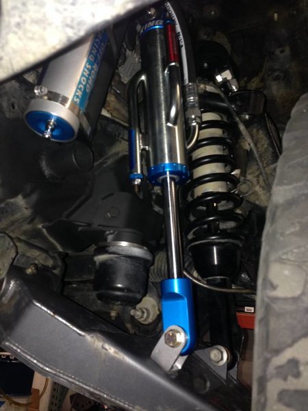

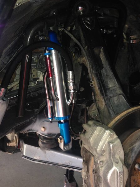

    @Airdog did you have to modify the stock bumpstop mount to fit your secondary shock? I have the same LCAs and was just fiddling with the secondary mount seeing it it would work for my limit straps. When I got the bolt on lower mount on I was surprised at how close it was to the bumps and wondered how a shock would fit in there.
  14. Jan 15, 2016 at 9:10 PM
    #754
    Airdog
    Airdog [OP] did your Mom
    Dec 26, 2012
    #93790
    4,905
    Tom
    SoCal
    https://www.tacomaworld.com/threads/airdogs-2012-prerunner-access-cab-slow-build.264263/
    The Total Chaos hoop kit comes with a new bracket for the bump stop. You cut about half of the stock bump stop bracket off and attach the TC one. Its a bolt on operation though I chose to weld my on also. You can see it in the pic below.
